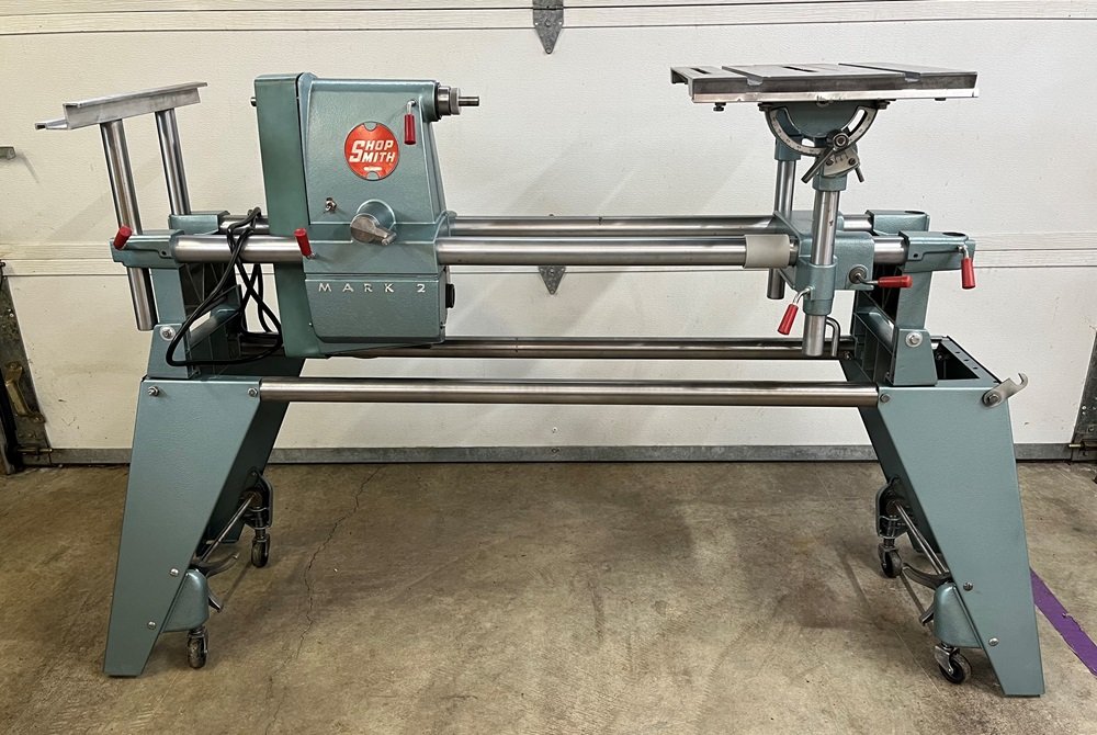

Since this topic has been resurrected and was originally posted prior to my joining the Forum I thought I would chime in with information I have about the Mark 2. I own two Mark 2 tools, one restored and the other waiting (still) to be restored. Below is my restored Mark 2
_
This is information I have previously posted in other topics about the Shopsmith Mark 2
1958 to 1960 Mark 2 (5-in-1)
Introduced in December of 1957 by Magna Power Tool Corporation. This unit was made at Montgomery Ward’s request and sold primarily by them. It was not made to the same quality standards as the Mark 5 and was a lower cost alternative while still providing the same five functions. It has an 8” saw blade capacity instead of the 9” saw blade of the Mark 5 at the time. The Mark 2 uses a ½ HP or optional ¾ HP motor while the Mark 5 had a ¾ HP motor that later changed in early 1961 to a 1-1/8 HP motor. It uses two 2-step pulleys (a 2”/3” and a 3”/4”) to change the 7 speeds much like the Model 10E and 10ER instead of the variable speed of the Mark 5. The Way Tubes are shorter at 48” long. An interesting feature of the Mark 2 is the Headrest which is a pin-able version of the Base and Arm which functions much like the newer Mark 7 Double Tilt feature. It has lower quality locks to hold the headstock, carriage, etc. in place. They work like the locks found on the Model 10’s but are made of lower quality materials and finish. It has an extra saw blade slot on the main table (a feature added to the Mark 5 in the 1960’s and 1970’s). Some Mark 2’s have round metal bench tubes while others have rounded top rails made out of wood to connect the bench ends and legs together. It could be purchased with or without the bench. Instructions included making your own wood bench. The Miter looks similar but is different than the Mark 5’s as it has no angle stops and a shorter bar without the lock to hold it in place in the table slot. It has a narrow step shape extension table that creates its own fence and serves as the tailstock with a small block attachment. There are very few individual parts that are interchangeable with the Mark 5. The Mark 5 Headstock will fit on the Mark 2 frame. Even the table system can be changed to the Mark V or 7’s. The Mark 2 can also hold and power Add-a-tools later known as Special Purpose Tools made for the Mark 5/V’s and Mark VII/7’s. It has only one hub for powering SPT’s so different length posts may be needed for some SPT’s. It started out with the “Greenie” colors and later changed to gray.
At the time of its introduction the Mark 2 was priced at $179.90 (less bench and motor) compared to the Mark 5 at $329.50. The Bench legs with tubes cost $19.95 and the ½ HP motor was $34.95 making the total for a Mark 2 to be comparably equipped to the Mark 5 at $234.80 and still considerably less than the Mark 5.
The Mark 2 works more like it’s a Model 10 trying to look more like a Mark 5.
At some point it was sold with a Wards Powr-Kraft label replacing the Shopsmith logo/serial number plate. That model also had a variable speed pulley system.

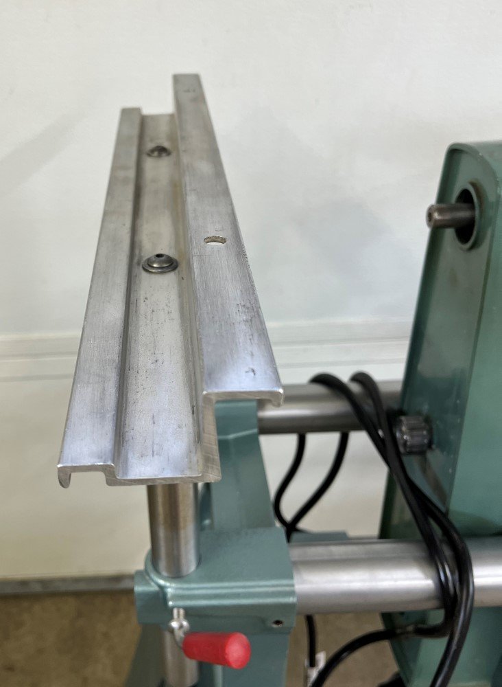

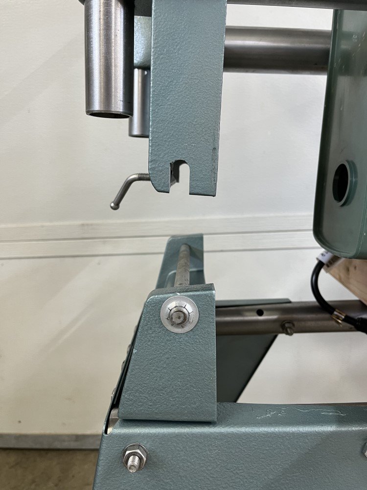

The following pictures show some of the differences of the Mark 2. The first is the pin-able Headrest.
_

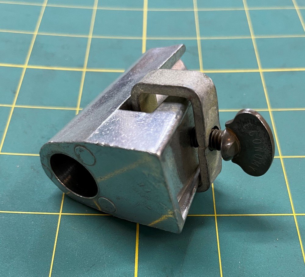

Below is the Extension Table followed by the Tailstock attachment the clamps on the Extension Table.
_
Extension Table.jpg (75.46 KiB) Viewed 72478 times
Tailstock - front.jpg (165.3 KiB) Viewed 72478 times

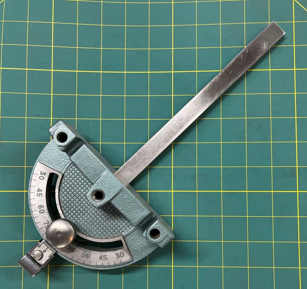

Below is the Miter. Notice the bar has no locking set screw. It does not have angle stops either.
_

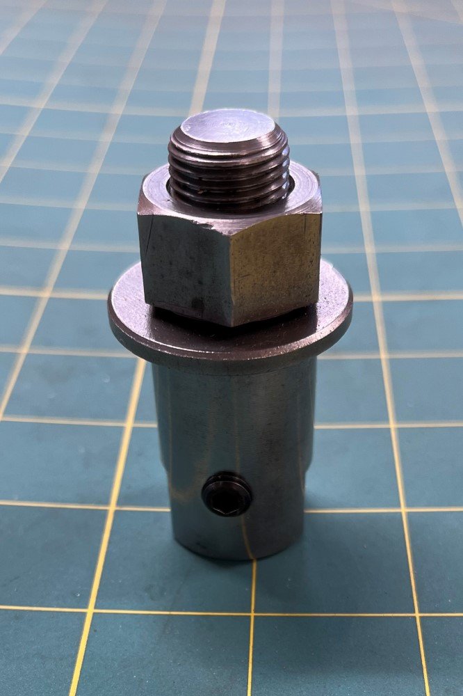

It came with its own 5/8" Saw Blade Arbor. It is different from all other Arbors made up to that time and since.
_
Mark 2 Arbor.jpg (86.61 KiB) Viewed 72478 times

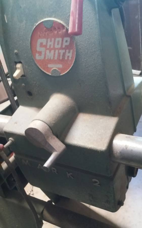

The Headstock on my restored one is not the original Headstock that came on that tool. I found a replacement because, as seen in the picture below, someone had cut holes to mount a household light switch instead of replacing its original power switch. There were also numbers "stamped" in the logo/serial number plate I didn't like. Because of this the identity (serial number) changed to the replacement Headstock's serial number.
