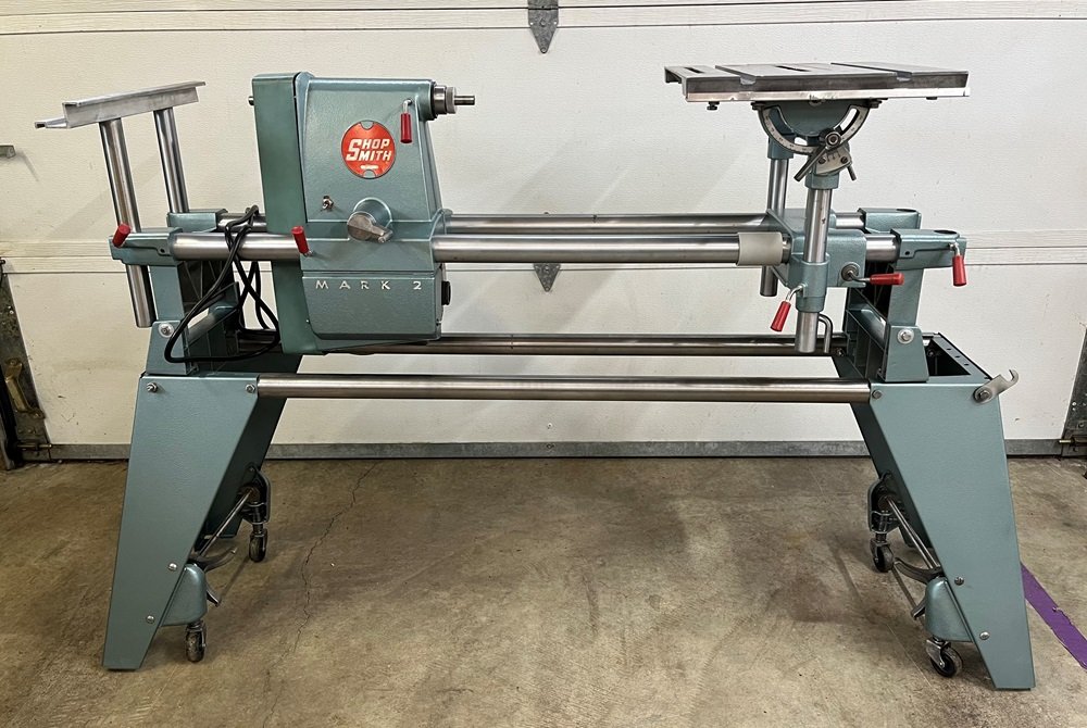

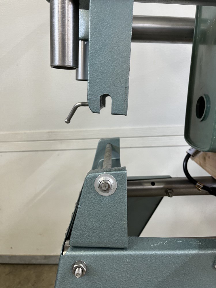

Since this topic has been resurrected and was originally posted prior to my joining the Forum I thought I would chime in with information I have about the Mark 2. I own two Mark 2 tools, one restored and the other waiting (still) to be restored. Below is my restored Mark 2

The following pictures show some of the differences of the Mark 2. The first is the pin-able Headrest.
_
Headrest and Tie side view.jpg (112.47 KiB) Viewed 72494 times

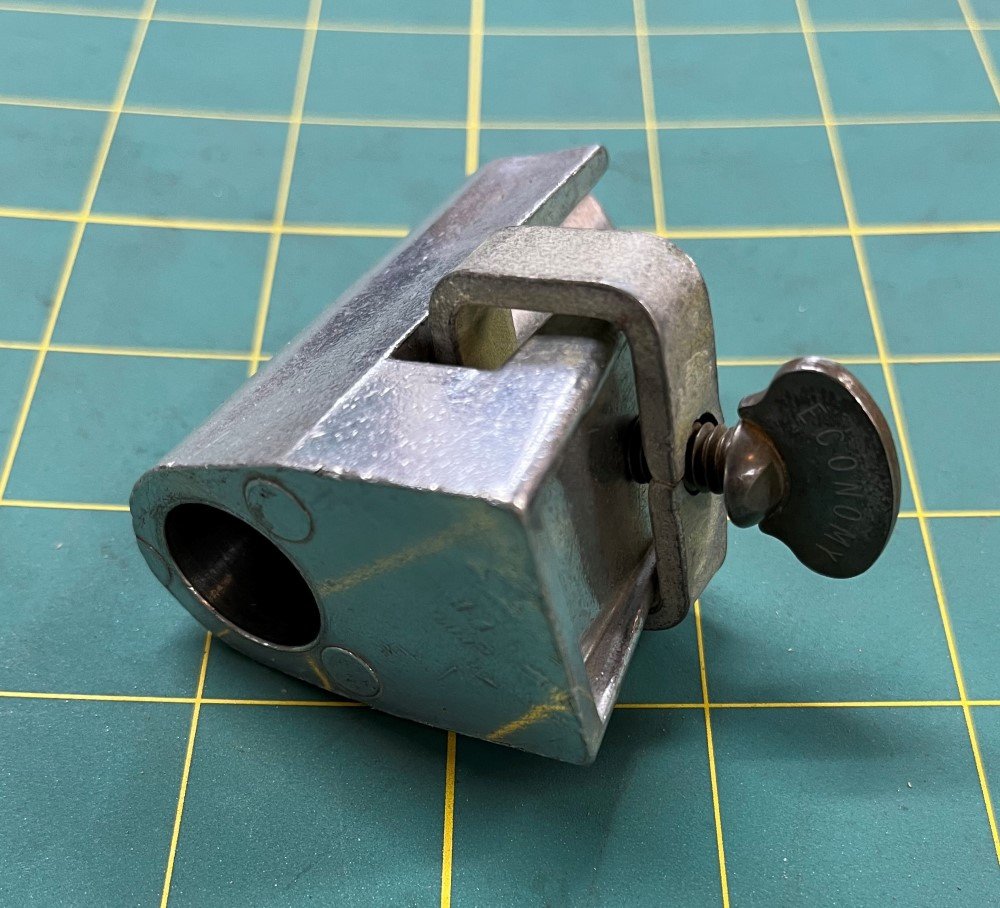

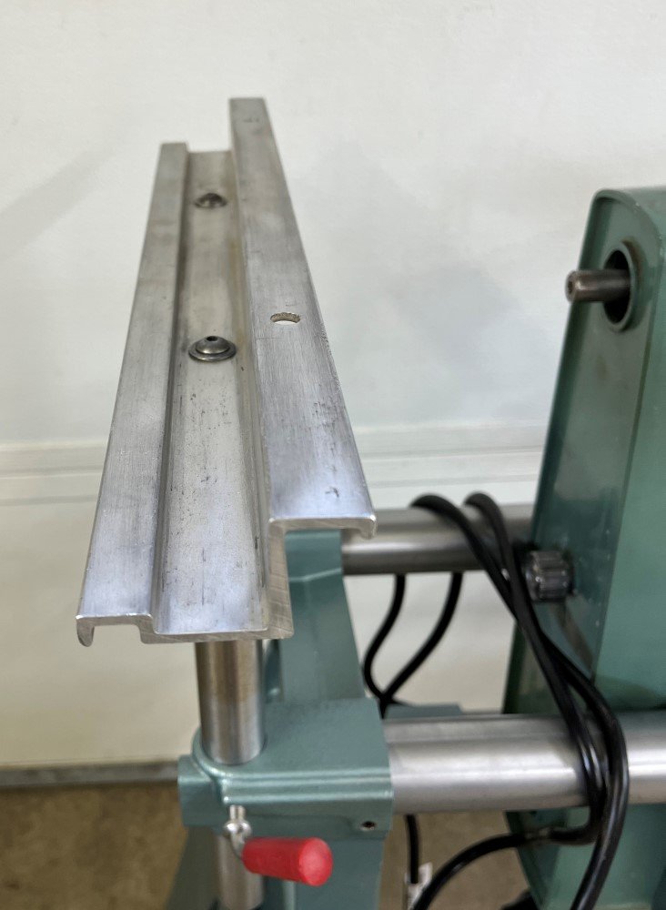

Below is the Extension Table followed by the Tailstock attachment the clamps on the Extension Table.
_
Extension Table.jpg (75.46 KiB) Viewed 72494 times
Tailstock - front.jpg (165.3 KiB) Viewed 72494 times

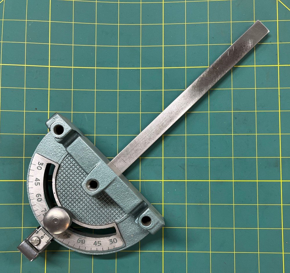

Below is the Miter. Notice the bar has no locking set screw. It does not have angle stops either.
_

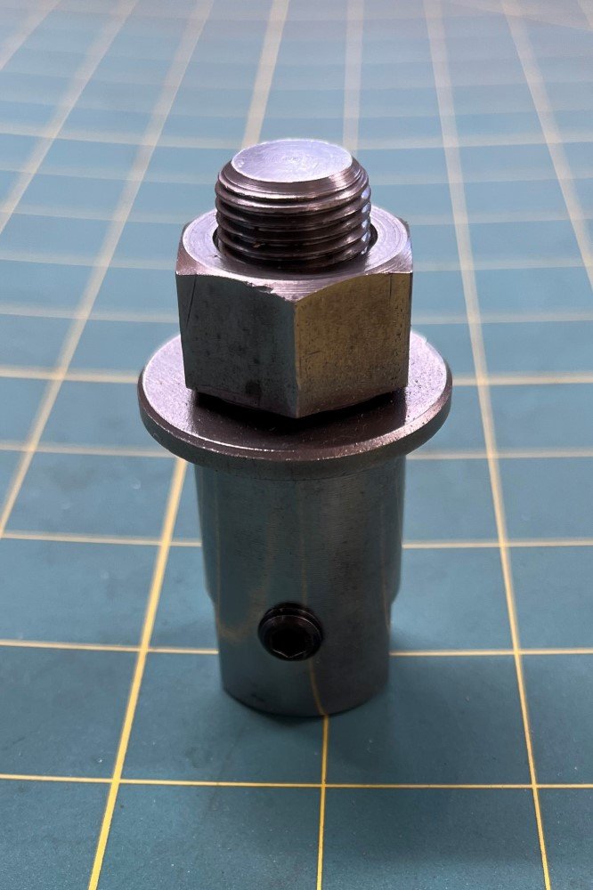

It came with its own 5/8" Saw Blade Arbor. It is different from all other Arbors made up to that time and since.
_
Mark 2 Arbor.jpg (86.61 KiB) Viewed 72494 times

The first picture in my previous post shows the Mark 2 I have already restored. It is all Mark 2 parts as it came from the factory with the Bench and 1/2 HP Motor options without any upgrades except the Retractable Caster Set. I was able to find a Mark 2 Caster set as these were apparently not very common. They look and are mostly the same as the Mark 5 Retractable Casters but have a shorter Drive Rod and Tie Rod. Having the Castor set also provides more stability to the legs.

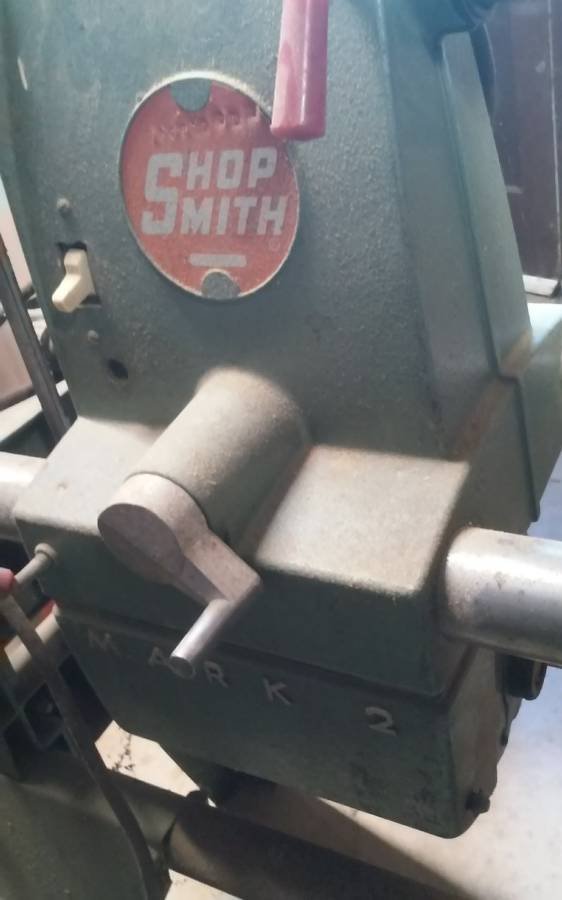

The Headstock on my restored one is not the original Headstock that came on that tool. I found a replacement because, as seen in the picture below, someone had cut holes to mount a household light switch instead of replacing its original power switch. There were also numbers "stamped" in the logo/serial number plate I didn't like. Because of this the identity (serial number) changed to the replacement Headstock's serial number.
