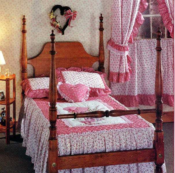

The other day I ran across plans for a four poster bed in Shopsmith's FREE plans. Since the posts look to be about 6 ft. tall.
I looked to see how this was done on a Shopsmith.
[ATTACH]5810[/ATTACH]
The plans show the posts were made in separate, shorter sections. The sections were mated together with 'mortise and tenons' (my terms). One of the mating pieces had a spigot (a round tenon) on one end and the mating piece had a mortise (a counter bore). Take a look at the plans, by going to "Shopsmith Owner's Web Site" and clicking on "Free Project Plans" (found in the left column).
This methodology shows me that long columns can be successfully turned on a Shopsmith, without machinery modification.
