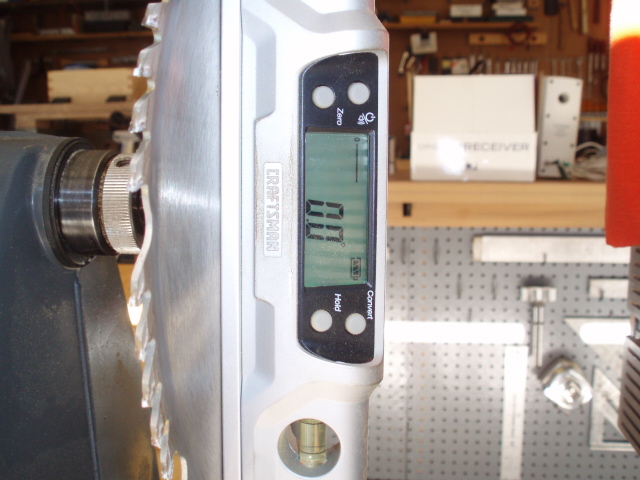

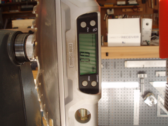

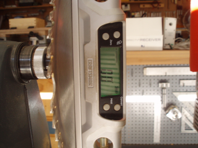

I think the beginning of this procedure is with the blade. There are many (and more accurate) ways to do this but it is necessary to ascertain that the blade does not wobble.
The technical term is runout.
I am only performing a quick and dirty test to determine if I want to proceed with a total alignment of the Mark V. If the blade does not rotate in a single plane, there is no need to go further. I normally use a Wixey for this test but here I am using a newly acquired digital level.
With the level attached to the blade, take a reading. Holding the level in the same position, rotate the blade a small amount and take another reading. Do this multiple times. If the blade is NOT running true, the readings will differ. The greater the deviation the greater the problem. It would be nice, in an absolute world, to get 0.0 degree readings at every point of rotation.
I accept .2 degrees as an acceptable deviation. If blade orientation doesn't pass this test with flying colors, STOP. There is a problem that must be corrected.
The Single Point of Reference: I consider the face of the blade to be the single point of reference for all other table alignments. There might be debate on this but that is my personal viewpoint.
