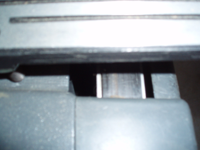

I think this shows it all:
[ATTACH]5897[/ATTACH]
The gap to the left of the lower wheel measures 1/2" (wheel to housing).
