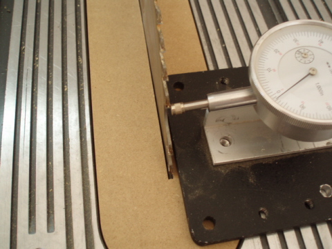

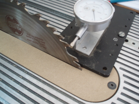

I set out today to measure runout on the blade. I am getting some quirky readings so I am seeking opinions on my test set up.
Please note that I am taking my readings on the very edge of the carbide.
Do you see anything inherently wrong with this set up?
[ATTACH]6009[/ATTACH] [ATTACH]6010[/ATTACH]

I don't think anything is inherently wrong with your set up. I check for run out slightly different. I set up my indicator inside the teeth on a flat part of the blade and lock the indicator. This way I can rotate the blade without the tip of the indicator falling into the gullets. My method works for a standard runout check but it may not find an errant tooth on the blade.dusty wrote:I set out today to measure runout on the blade. I am getting some quirky readings so I am seeking opinions on my test set up.
tdubnik wrote:I don't think anything is inherently wrong with your set up. I check for run out slightly different. I set up my indicator inside the teeth on a flat part of the blade and lock the indicator. This way I can rotate the blade without the tip of the indicator falling into the gullets. My method works for a standard runout check but it may not find an errant tooth on the blade.
I normally check for run out the way you describe. I also use a round tipped adapter rather than the flat tip. I used a flat tip here so as to stay on the corner of the carbide more easily.

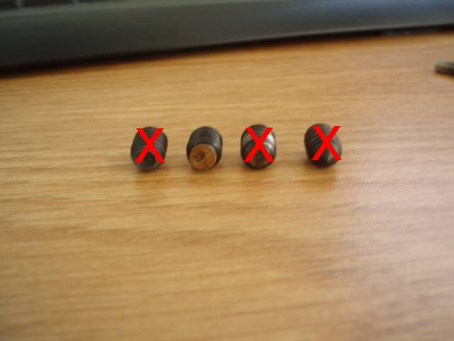

Ed in Tampa, You got me to thinking. While I was working on the saw dust problem, I noticed that the table was no longer square to the blade. With the blade protruding through the insert (ZCI) I loosened the table tilt lock to square it up. It was tight and I had to use some force. With the rip fence still mounted, I lost control of the table and exerted some pressure on the blade (tilting the table) and I might have bent the blade some.
Also, I recall that on occasion I find the arbor set screw a little loose. So, I checked all the set screws to see if I could properly losk the arbor to the shaft.
What I have to show now may be at least part of my problem. I found three of these in my arbors (not the conical on the right). Which one is correct?
[ATTACH]6012[/ATTACH]
- P9190024.JPG (104.56 KiB) Viewed 11379 times
