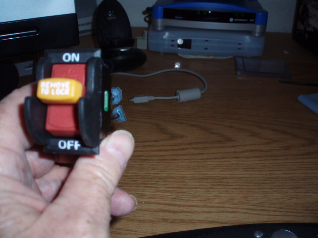

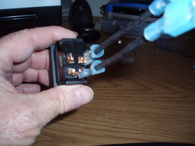

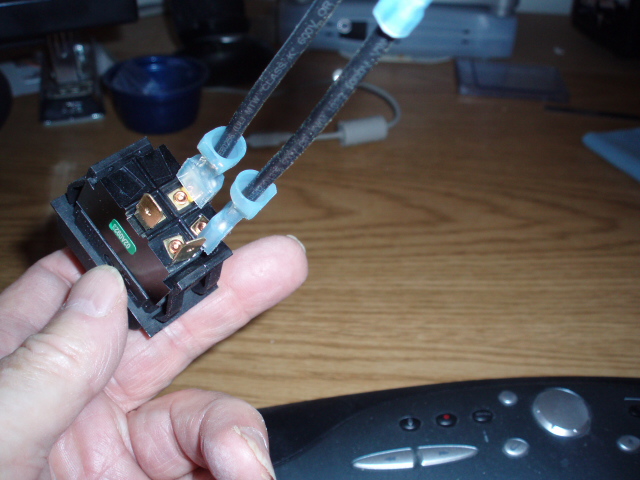

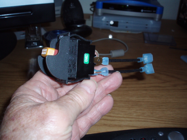

There are so many different physical configurations that a switch could be. But if it goes into a Mark V, this might be one of them. Hope these help.
[ATTACH]6076[/ATTACH]
[ATTACH]6077[/ATTACH]
[ATTACH]6078[/ATTACH]
[ATTACH]6079[/ATTACH]
Connect the two black wires (one from the motor and one from the power cord to the two terminals with black wires (in the photos).
The two terminals with no wires are actually another switch that can be used should this one fail. This is a double pole single throw switch (DPST).
The switch in these photos is the new switch that I recently received from Shopsmith for use in my Mark V.

Dusty thanks. I had the two black wires opposing each side. I followed your picture and put them on the same side top and bottom. Saw powered up. Back to my strom windows. Thanks a lot. Long time shopsmith user, first time using this forum.
