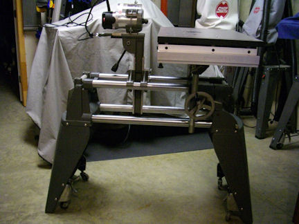

Today I assembled a base and table for a Mark V 520 upon which the overall length has been shortened 18" and does not have a headstock. The OPR has also been installed. Many thanks to Bill Mayo for his guidance and helping me find affordable parts.
Now that I have assembled my latest dream I realize the Way Tubes need to be shorter yet. I have two concerns. First one I have centers on how short dare I make them without being concerned with the Table, OPR, Router and projects flipping the stand over in my lap. Secondly I really need to minimize the overall length as I am running out of space in the shop. I am wondering if anyone here has faced this issue and if so what works? What doesn't work? Your thoughts will be welcomed. FJIMP

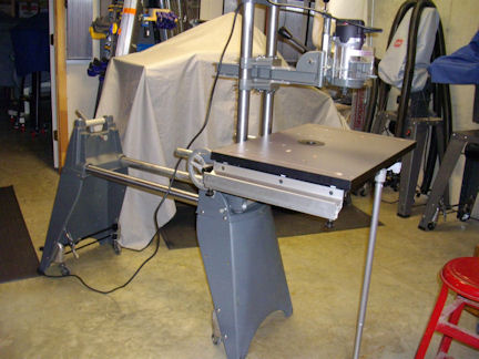

Wow my buddy showed up about 4 PM today. He had a steel tube cutter with him. As he was an hour early I didn’t even have the stand torn down yet. 40 minutes later we had it torn down all four tubes shortened an additional 12" and reassembled. I wanted to post a picture and decided to await a bit of cleaning and polishing yet to be completed.
[font="]I am very pleased. I expected the tilt question to be worsened yet find it identical to before. I do believe the Shopsmith Telescoping leg will be sufficient support. Jim:D:)[/font]

Picture of New OPR Stand
At last I have pictures of my new OPR stand. I need to point out that Bill Mayo was a great deal of help finding th parts I needed to make this possible. Jim
- 20091030_1.JPG (39.68 KiB) Viewed 6040 times
- 20091030_2.JPG (44.83 KiB) Viewed 6032 times
