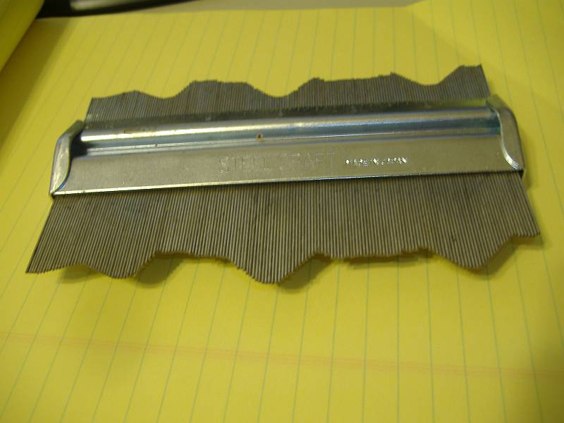

Sorry but lots of brain clouds today so I don't even remember the proper name for this tool...
Anyway I found it tucked away in the father-in-laws shop and attempted to use it to get a pattern to dupicate a piece of missing molding. I think it sat to long.... I cleaned it up but it is still so stiff that it would work as a saw if you put that pattern on it.
So anyone have any thing they have used to get these thing sliding again? Got to be something that will not affect the molding or finish on the existing part to be copied.
Oh yea a picture of the tool:
[ATTACH]6317[/ATTACH]

mickyd wrote:Contour gage.
Yep.
I just use WD-40 but then I also use axle grease on my watch.
I suppose Johnson's Wax would work well too.
IF steel, try electrolysis like ya did the chuck. Maybe the reaction will clean the innards. Move the pins to one side before hand. Evaporust might also work.
Post processing, wd40/wax after cleaning the blox off it.

Hi Ed! I'd use WD-40 applied amply. After it gets cleaned up and slides fairly easily, spray on silicone, that will replace the WD-40 and give a better feel to the sliding. Also use a lot of the silicone.
After it is smooth - wipe it down well with dry paper shop towels. You Know - the blue ones.
You might try soaking it in Kroiloil for a day or two.
