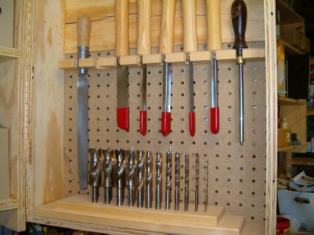

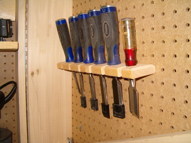

Although I have only the basic SS set of lathe tools, my storage of them is safe from any damage. Here is a photo showing the storage, but this type of shelf doesn't have to be in a cabinet. You could make several of these to fit on a roll around cabinet. I've used the same system for some bench chisels.
[ATTACH]6330[/ATTACH]
[ATTACH]6331[/ATTACH]

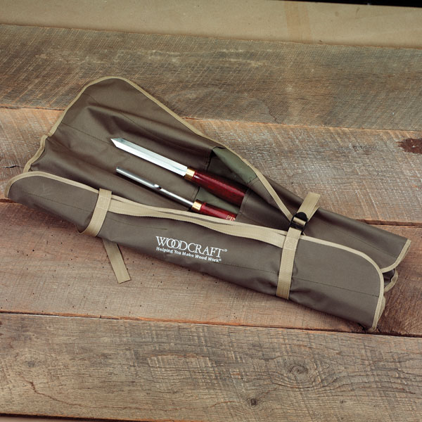

John,
Here is what I use. They are so cheap I bought 2 of them...
Turning Tool Roll
But you better hurry. The sale ends Oct. 31.
