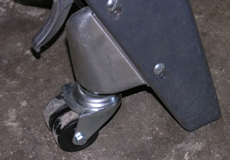

Farmer,
I don't use any fixed casters on my SS, but I do use dual wheel casters on bearings. Easy to move and precise. McMaster/Carr carries them.
ldh
[ATTACH]6360[/ATTACH]
[ATTACH]6361[/ATTACH]
[ATTACH]6362[/ATTACH]

Anyone else notice the 'run stains' inside the legs in pix 1????
Did you need to relocate the casters, or were they the same dimension?

Post by ldh »
JPG40504 wrote:Anyone else notice the 'run stains' inside the legs in pix 1????
Is the run stain some type of disease that I should know about? I certainly don't want any of my other Shopsmiths to catch it. I did have to relocate the attachment holes slightly higher on the SS in the pics, but that is not the case with every machine. The 520 in my shop here did not require any change in mounting the casters. It is quite easy to change the casters to see if any change will be needed.
ldh
robinson46176
Posts: 4182
Post by robinson46176 »
ldh wrote:Is the run stain some type of disease that I should know about? I certainly don't want any of my other Shopsmiths to catch it. I did have to relocate the attachment holes slightly higher on the SS in the pics, but that is not the case with every machine. The 520 in my shop here did not require any change in mounting the casters. It is quite easy to change the casters to see if any change will be needed.
ldh
Kill the Tom cat or cure the shop sweating problem. :)

JPG40504 wrote:The reason this 'subject' has been brought up is that the cause has been discussed b4 with no definite conclusions being determined. Do you have an explanation?
JPG,
The pics are from a used 520 and I have no idea where the stains came from.
I honestly don't pay much attention to the cosmetic aspect of the machine, just its performance and my Shopsmiths have worked wonderfully for me over the years.
