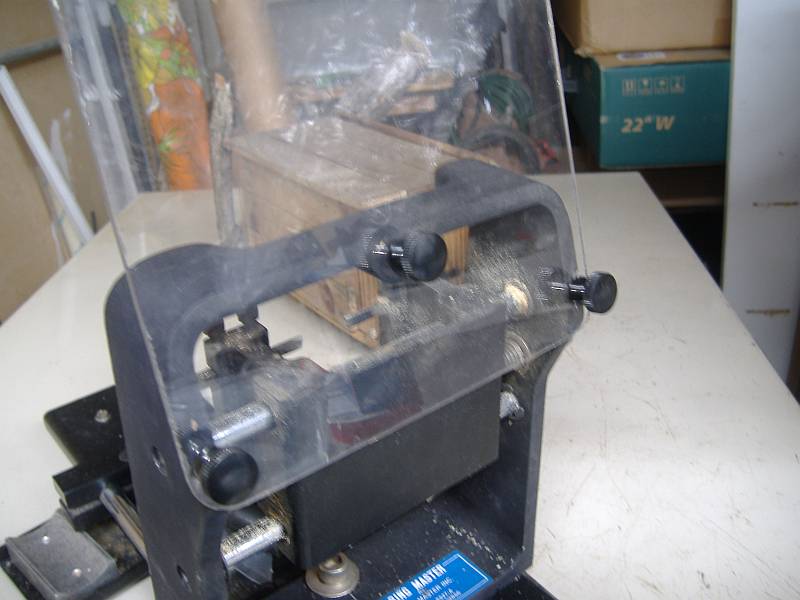

Hi,
For those ring master owner, how are you storing your ringmaster? So far I haven't come up with much other then a plastic tub that seems to collect what ever I don't know what to do with. I'm out of wall space to hang things so that's a bust.

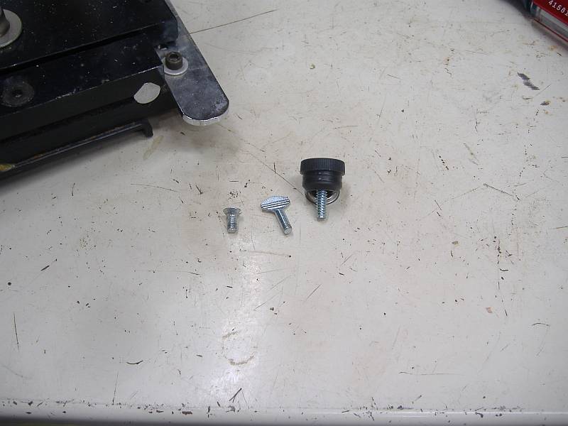

Second thing is I like to remove the shield for setting the knifes and for storage. I'm getting real tired of the little screws and always having to go for a screw driver. I picked up some thumb screws but they are not making me happy either. What I would really like is a knob but I have been unable to locate one at the local hardware stores or even at my favorite on-line shopping places (#8-32). It looks like I have the room to drill them out and go with #10-24 but I'd kind of like to stay original.
Below is a picture of the present shield mount followed by a shot of the original (at least this is how I got it.... used) screw, the thumb screw and what I'm looking to find.

Hi Ed,reible wrote:...Second thing is I like to remove the shield for setting the knifes and for storage. I'm getting real tired of the little screws and always having to go for a screw driver. I picked up some thumb screws but they are not making me happy either....
Ideas, solutions, whatever???
What is the issue with using the thumb screws? I am guessing that they do knot hold the shield tight without adding something like a washer on to them? And then it is difficult to grab-hold of them to turn? If that is the case, could you have someone braze a small rod (or something similar) on to the "flat" of the thumb screw for easier "grab-ability"? Or maybe that is knot the issue?
Tim
Look for brass thumb 'nuts'. Like the ones on the old electric fence dry cells. They are available in different thread sizes. Either run a bolt through one to add a threaded stud, or run a short piece of threaded rod(or a cut off bolt) into the hole and bottom it out so it is held captive or locktite either the stud or the bolt through the knurled 'nut'.reible wrote:Hi,

Hi,
The thumb screws have two issues, one is that they are hard to start, you have to hold the guard in place and line up the hole then start the threading in. The thumb screw is good for a part of a turn but then required you reposition to keep turning. The second issue is having to have a washer, (just like the other screws) the washers have a tendency to fall to the floor and hid under some thing or other. The other issue you mentioned of them being small and difficult to turn is another matter but a notched dowel could be used to tighten or loosen them. I think more then anything I really want a knob that will work without a washer.

a1gutterman wrote:Hi Ed,
Hi,
Yes I can see what your idea is. I may even have some tucked away some where in my collection. Your idea also gave me another idea of maybe using a wire nut and some epoxy???
Got a lead to a place that stocks a lot of specialty items that is local. Hope to visit them today and see if they have what I want. I was also told to expect to PAY for them as this is not what you find in the normal hardware stores anymore. It might be worth extra to keep them around if they indeed do have a lot of this sort of item and they are close by.
JPG40504 wrote:Look for brass thumb 'nuts'. Like the ones on the old electric fence dry cells. They are available in different thread sizes. Either run a bolt through one to add a threaded stud, or run a short piece of threaded rod(or a cut off bolt) into the hole and bottom it out so it is held captive or locktite either the stud or the bolt through the knurled 'nut'.
These knurled 'nuts' resemble the nuts that clamp the blade loading slot in the bandsaw table and the belt loading slot on the 1" belt sander, but have smaller threads and od.

I got the three knobs that I wanted but I really did PAY for them. Unlike the more normal sized ones these cost me $2.70 ea. The good part is they were just what I was looking for and I really like how they work and feel. Since I didn't pay any where near list price for the ring master I though I would treat myself to the knobs... and maybe a tool box to store it in.
...reible wrote:I got the three knobs that I wanted but I really did PAY for them. Unlike the more normal sized ones these cost me $2.70 ea. The good part is they were just what I was looking for and I really like how they work and feel. Since I didn't pay any where near list price for the ring master I though I would treat myself to the knobs... and maybe a tool box to store it in.
