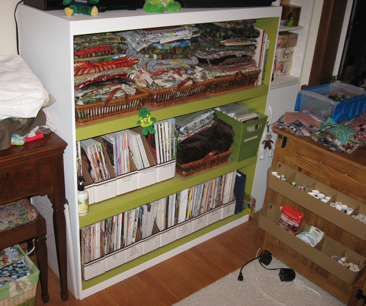

If you plan to paint the shelves it can be done quite inexpensively. I made this shelf for my wife to use in her sewing room. Sides and shelves are 1/2" ply the back is 1/4" ply. Each shelf has 2" x 2" pine attached with glue and screws on the bottom of all four sides. The sides and back are glued and screwed to the 2" x 2" edging. The shelves are 43" long, zero sag and quite strong.
[ATTACH]6473[/ATTACH]
The main disadvantages of this system are that the shelves are not adjustable and you do lose height to the reinforcing 2" x 2"s. If you plan on using a more traditional design with adjustable shelves then the 3/4" ply would make better sides as it will be less likely to bow outwards. Save the solid wood (if necessary) for the shelves.

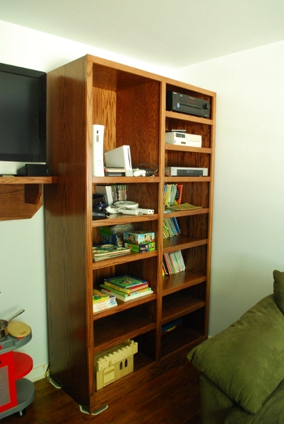

Here is a book/AV shelf that I made. A friend of mine runs a small cabinet shop and recently acquired a cnc router. I wanted to give him some business and watch it in action, so he cut the frame and shelves for me. It is made from 3/4" red oak ply with 3/4" red oak trim. Simple, but it works well and is very solid. It was a lot of fun watching the router fly through the job, especially all the holes for the adjustable shelves.
Loren
[ATTACH]6474[/ATTACH]
hobbydad wrote:Here is a book/AV shelf that I made. A friend of mine runs a small cabinet shop and recently acquired a cnc router. I wanted to give him some business and watch it in action, so he cut the frame and shelves for me. It is made from 3/4" red oak ply with 3/4" red oak trim. Simple, but it works well and is very solid. It was a lot of fun watching the router fly through the job, especially all the holes for the adjustable shelves.
Loren
NICE! Interesting library!:) Toy shelf also I see.:cool: Interesting feet.:confused:

hobbydad
Posts: 76
Joined: Tue Jun 23, 2009 3:00 pm
Location: Southern WI
Post by hobbydad »
JPG40504 wrote:NICE! Interesting library!:) Toy shelf also I see.:cool: Interesting feet.:confused:
The "feet" are for sliding it around. I took that picture while I was still working on hooking up the A/V stuff.
