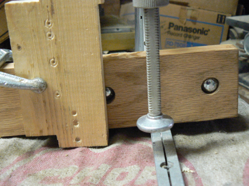

A Che...more cost effective less 'handy' method(works just as well).ldh wrote:tsaguy,
Take a few minutes and construct a sliding fence or two for your Miter Gauge in what ever lengths you need. BB ply 3/4", 1/4x20 T-track, and sandpaper face. The knobs are from Winco.
ldh
[ATTACH]6475[/ATTACH]
[ATTACH]6476[/ATTACH]
[ATTACH]6477[/ATTACH]
[ATTACH]6480[/ATTACH] [ATTACH]6481[/ATTACH]
The fence extension may be anything(needs to be straight), the knobs from Woodcraft, the bolts/washers from local hardware store the clamp from Sears .
