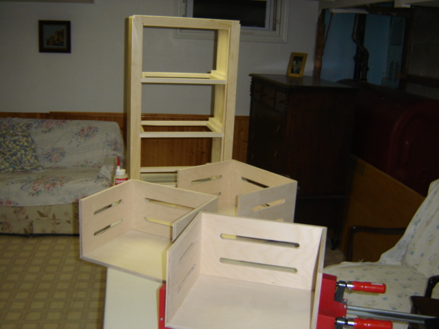

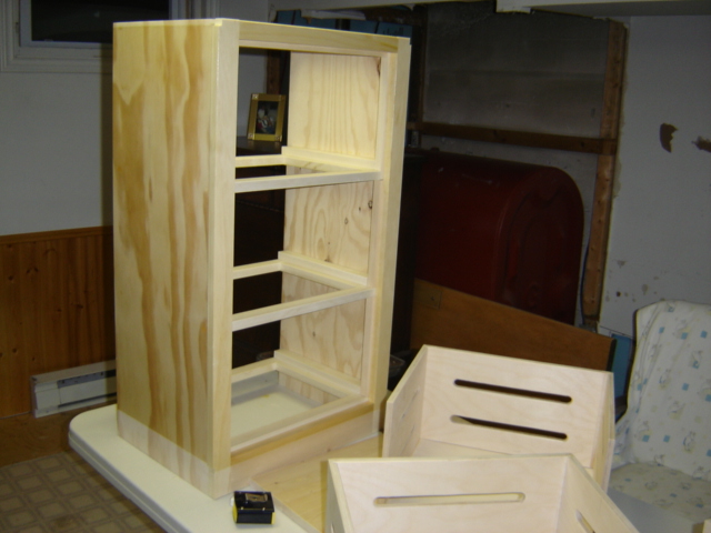

The first problem I encountered was whille routing a profile on the edge of the base trim. a large splinter of wood came off ruining the top edge. I was thinking maybe a dull bit caused this mishap. It was even more frustrating since I had found a clear piece of pine in the cheaper knotty pine bin at HD and I was planning to have the grain wrap around the three sides of the bin. I may be able to save the piece but I haven't tried yet as I was in cool down mode and moved on.
The next phase was to drill 5/8" holes in the BB side and backs of the drawers. I had the depth set to drill so only the point would pierce the back side and I would finish drilling from there to avoid tearout. After several holes, I ran into a problem I have experienced before and which others have mentioned in that the holes became shallower as I progressd. I tried to stop this by supporting the table with the extendable leg but no such luck. With a total of 36 holes to drill, adjusting the depth after every one or two holes became more than a little annoying. But they did get done.
After connecting the holes by cutting a slot on the scroll saw, the next step was to rout a roundover on the slots. This was not called for in the plans but I thought it would add to the appearance. While doing the first one, my router blade started jumping wildly. Fortunately the router was table mounted so there was no real danger. When removed from the table, the blade/spindle cannot be moved from side to side by hand, but it sure has plenty of movement when spinning at 10,000 revs/min. I was able to finish the job with my old router but I think the newer one is now scrap. Maybe my previous splinter problem was really the start of this major breakdown.
I have attached picures to show work in progress. The side of the bin shows where the base molding is supposed to go.
Next up is to start on the face frames that complete the drawers. Then I will have to tackle flattening the top which is made up of three cupped boards. Of course they would not be cupped if I had had my jointer working:(

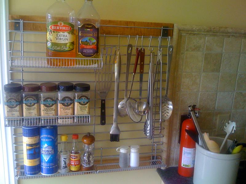

Nice looking set of bins! I was able to finally finish up a few boards needed to hang a rack in the kitchen.. I visited my local Rockler store to get a countersinking bit + some decent looking screws to attach the boards to the studs in the wall.. The unit itself was purchased at the local Container Store about 4-5 years ago and remained in a bag until this weekend.. Anyway, I ditched the supplied screws and used the same brass colored screws to attach the brackets to the 1x maple boards. Not tons of effort here but it WAS my first Shopsmith project since buying it >1 year ago.. Sheesh.. Anyway, I was able to use the (properly aligned) table saw and jointer for this project..

John - Hey! that bin is coming right along! Lookin' good too! Must be a pleasure working with straight, rather than bowed, plywood! Sorry to hear about your router, wish I could guess what went wrong, but can't.
Rick, nice lookin' rack, mounting looks good! Also a slick (pretty) kitchen. Glad you were able to use your Mark V.

Now that you have that job done you can expand and start your second project. I have a wine glass rack I made about 10 or 12 years ago for under the kitchen over head cabinets... now when I find the wood again I'll finish it and put it up. So from my prospective you really got on this project.
Looks like you guys are eating healthy, good for you.
