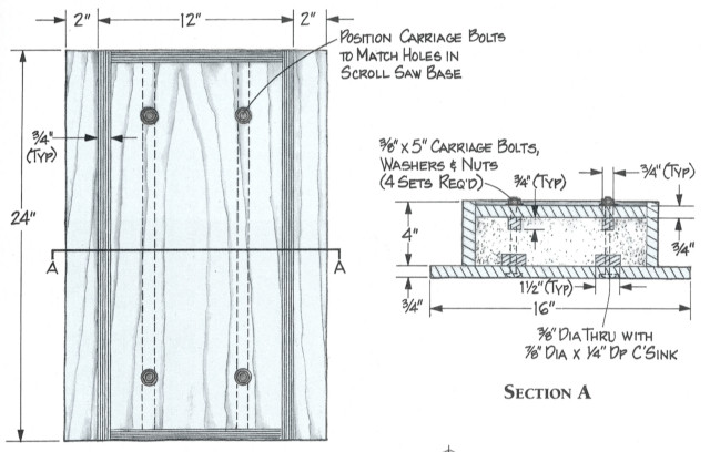

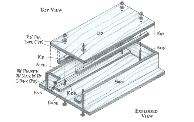

It's a good idea, Ed, but it's not quite as simple mounting the Mark V on a box of sand. To get the maximum effect of the hysteresis, the machine actually has to "float" on top of the sand. In my book Using the Scroll Saw, Jim McCann and I designed a sand base that would suck the vibration out of a benchtop scrollsaw. It worked like gangbusters -- you could balance a nickel on edge on the table of a low-end Delta when we were through. You might build a somewhat larger version of this design for the Shopsmith.
[ATTACH]172[/ATTACH]
[ATTACH]173[/ATTACH]
[ATTACH]174[/ATTACH]
[ATTACH]175[/ATTACH]

Nick-
Thanks for taking the time to post the pictures of the scroll saw sandbox.
I had not thought of the adjustable top to allow taking up for the sand's reduced volume as it compacts. Your design looks like just the ticket. I don't see why a larger version wouldn't work for the SS.
Thanks for a great idea.
Idaho Panhandle
MkV 500

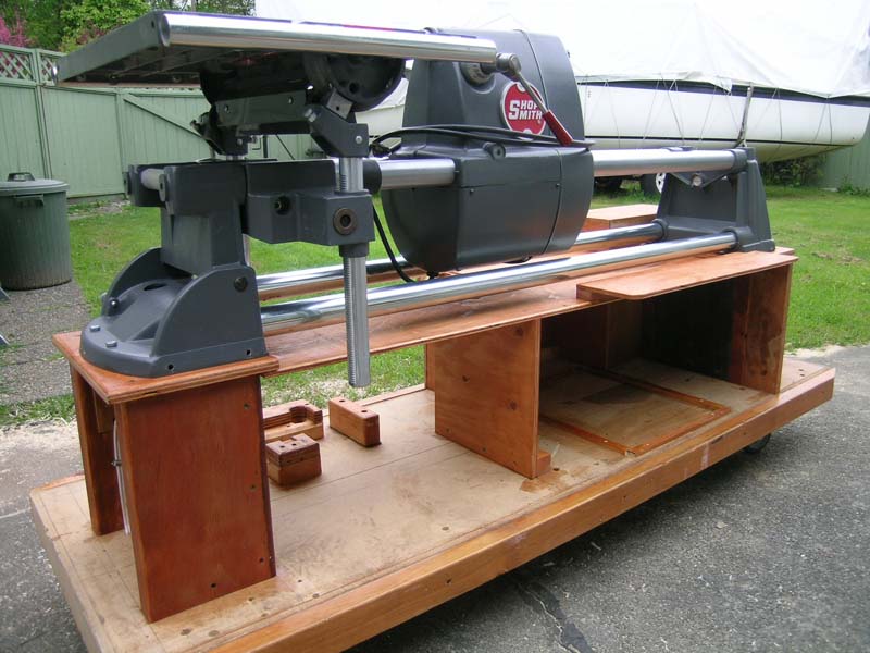

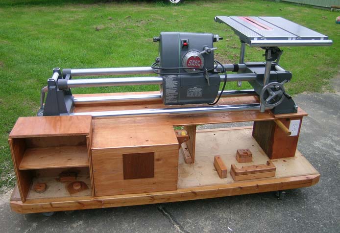

I use a solid 24x72x3 base to mount my SS for stability and to preserve alignments when I move the machine around from shop to patio to work.
I use columns but probably sand boxes could be used instead if someone wanted to apply the idea to mount the SS the columns could be modified.
Here are some photos of what I designed. I can provide measurements if anybody would like them. The area below the SS is to store a planer, jointer, ripping fence and accessories.
