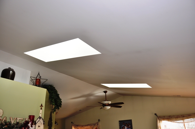

The second project is to build two stained glass windows to cover the skylights in the family room. I inquired at a local art shop and was quoted $600.00 per window or $1200 for the project. I have never done any stained glass work so I looked on the internet and found several sites with instructions. One of the best is here. http://www.freepatternsforstainedglass.com/index.html

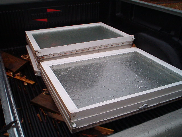

Also my neighbor recently installed new windows. I could not see the old glass going to waste so I am using the clear glass from these windows.
[ATTACH]6537[/ATTACH]

I have attached a before photo of the sky lights
[ATTACH]6536[/ATTACH]
The goal for the windows is to add some color AND still let the light into the room. Since this was my first stained glass window I selected a simple geometric design of mostly squares and rectangles. This means my cuts will all be straight. I made a pattern an taped it to the work bench. I cut two boards for a 90 degree angle as a frame.

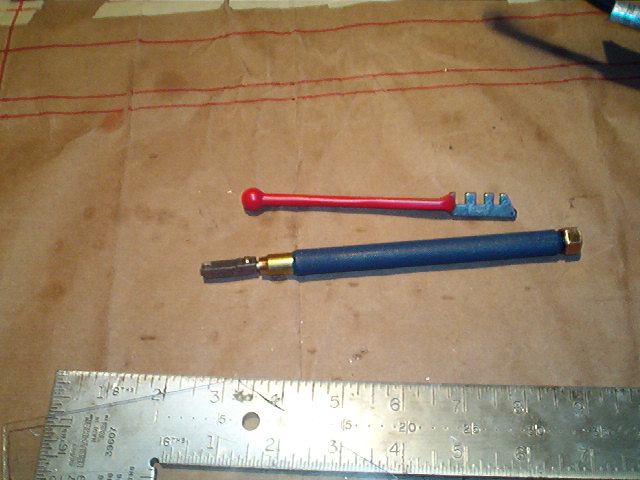

FIRST MISTAKE I made was purchasing the $20 glass cutter. The replacement heads are $15.00 each. It does not cut any better than the RED $3 cutter. I purchased from Menards.
[ATTACH]6538[/ATTACH]

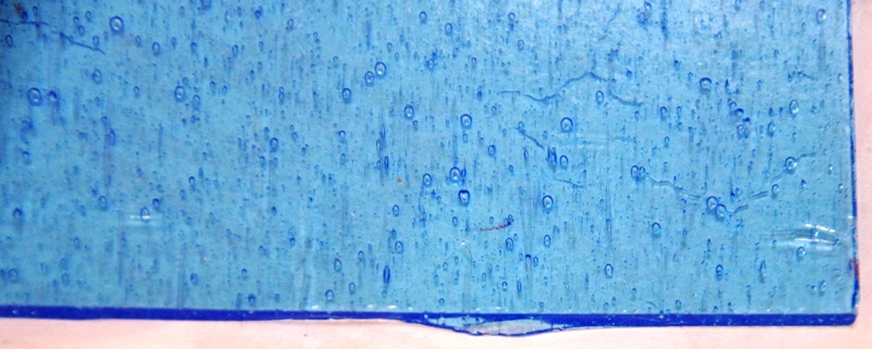

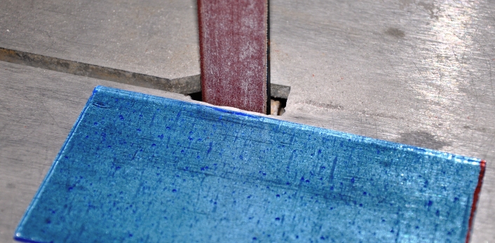

Because of the way glass breaks concordial fractures can cause irregularities. The quickest way to remove this is at the strip sander. Yes, I am sanding glass with 100 grit. This will take the sharp edge off.
[ATTACH]6539[/ATTACH]
[ATTACH]6540[/ATTACH]

Actually the expensive cutter does cut much better, The trick is to use kerosine to lubricate the cutter. I've been doing stained glass for over 30 years, and that is the cutter I use. The oil lubricates and clears the glass chips, no need to vacuum up the glass chips as they are contained in the oil, just wipe them up with a paper towel. If you have any m,ore questions, please PM me and I will be happy to help.

I would put a cushion(piece of wood or cardboard) between the glass and the strip sander table. Glass responds well to careful abrasion.

Hopefully you'll see the saving in longevity. (glass half full thinking,,,):D I had a cheapy that worked great for only several cuts.paul269 wrote:I started two projects and decided to merge the two........

Regarding the oil in the glass cutter, I saw a demonstration where a person was dipping the cutter into a small jar of oil. I cut the bottom of a soda can and placed two gun patches in the concave recess. Then I added a generous amount gun oil. I used both cutters and when scoring the glass it would leave a small amount of oil on the glass which is no big deal. But I still could not tell a difference between the two cutters.
I tried to fill the reservoir but found the cutter leaked too much.
What am I missing?
If you think the more expensive cutter will last longer, I can buy five cheap ones for the price of one replacement head.
What am I missing?

Horologist, I have not noticed an issue with dust from sanding the edges of the glass. I learned most people will use a grinding bit to smooth the edges. I am not sure how much dust that would produce. Perhaps dwevans could help out with this topic.

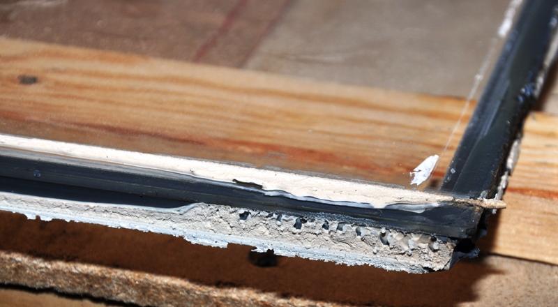

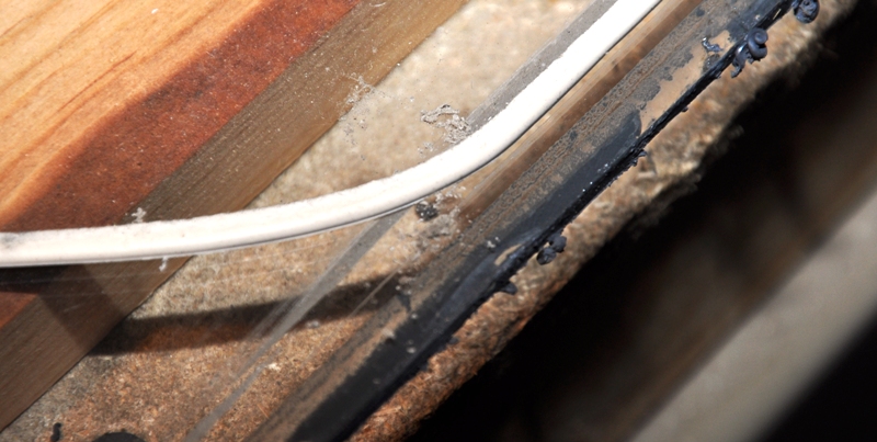

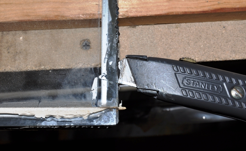

I removed the glass frame from the wood. Sandwiched between the glass panels is an aluminum track that the panels are glued to. I used a utility knife to cut thought the seal around the edge. I then had to scrape the excess from the glass panel with a razor. The exterior part of the glass had residual paint, and caulk left by previous owner. The All traces were cleaned with a shop rag and denatured alcohol. The aluminum track was discarded.
[ATTACH]6591[/ATTACH]
[ATTACH]6592[/ATTACH]
[ATTACH]6593[/ATTACH]
