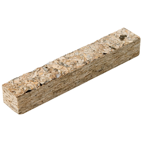

I've been getting a lot of requests from others for me to turn pens & bottle stoppers for them to give as Christmas presents. My son's Mother-in-law just dropped off kits & blanks for me to turn 2 pens, 2 pencils and a letter opener. She picked out the kits & blanks herself (luckily I already had bushings for the kits she chose)...
2 of the blanks that she chose were called Dakota Burl (from Rocklers), which is actually crushed sunflower seeds that have been compressed with resin to make a substance that looks similar to particle board. It's fairly light and drilled easily.
Has anyone else had any experience with this material? I'm wondering if it's going to be porous enough that I'm going to have to fill/seal it with a CA finish or if my "normal" finishing routine will suffice. Here's a pic of the Dakota Burl blank.

Well.... if anyone ever has the urge to buy one of these blanks and turn one... DON'T. I've never seen anything so porous (full of voids) and break so easily in all my life.

tom_k/mo wrote:Well.... if anyone ever has the urge to buy one of these blanks and turn one... DON'T. I've never seen anything so porous (full of voids) and break so easily in all my life.
I wondered...just looking at the picture...it looks like a piece of s...!

Would it have made a nice looking pen had it held together? How could the voids have been filled? Epoxy coating?

mickyd wrote:Would it have made a nice looking pen had it held together? How could the voids have been filled? Epoxy coating?
Mike, it would have been "interesting"... but the blank was made by compressing the crushed shells, and therefore there was definately a top/bottom and side to the pattern. Looking at the top or bottom you could see the shell pieces and it had interesting patterns. Looking at the side, it was just looking at the side of compressed shells, like a piece of plywood.
You could have stabilized and filled the voids with CA glue, much like when turning a corn cob, but it split before I could even get that far.
I found out this afternoon that when they went into Rocklers to choose their blanks, they had seen some burl pens I'd turned before and knew how nice they turned out and just looked for a piece of burl. Didn't find out until when they dropped them off at my house that it was "synthetic" burl made out of crushed sunflower seeds.
I went on Rocklers web site this afternoon and looked at the reviews people had written in for this blank... it was rated a 1-Star (out of 5).
