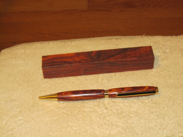

[ATTACH]6679[/ATTACH]Chambers84,
Took me a while to figure this out, but you will need to extend the quill in order to get enough clearance for the tool rest.
Have fun, I get a kick out of turning pens and my son loves to help.
