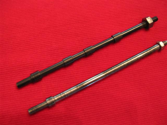

for the most part you are correct. the mandrels are 1/4" and the bushings have 1/4" holes regardless of the kit. these are called "A" mandrels and/or bushings. however there are still a few "B" mandrels out there for some of the larger kits. arizona silhoutteand berea still list a "B: mandrels and bushings. the "B" mandrel is about 5/16" in diameter so obviously the bushings are not not interchangeable. in the photo below is an "A" and "B" mandrel. the A on top, B on the bottom.
IMG_7340 (Small).JPG (39.86 KiB) Viewed 1417 times
