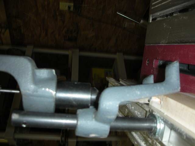

Thanks all. Ed has stated the issue better than I did. When I'm mortising a 3/4" thick stile, I use a 1/4" mortise that is centered, i.e. 1/4" from each edge. There isn't enough room for the mortise hold down and the mortise Chisel for both to "fit".
I've included a picture that may help show the issue. I guess I could always buy another hold down so I could put one on each side.

Greenvilleguy wrote:Thanks all. Ed has stated the issue better than I did. When I'm mortising a 3/4" thick stile, I use a 1/4" mortise that is centered, i.e. 1/4" from each edge. There isn't enough room for the mortise hold down and the mortise Chisel for both to "fit".
Looking at your picture you can see the foot of the hold down isn't even on the board, you holding board down by wedging the board in behind the hold down. The way to fix this is with an aux fence. Make it 3/4 inch thick and you should be good to go. This would happen with any fence 500, or 510. It is not a 520 fence problem just the nature of the beast.

Right. I happen to have a 3/4" aux fence already made up with T-Bolts and matching allen head bolts, but it's too thick. I believe the only solution is to make a 3/8" aux fence.
Thanks for your attention. I just wanted to make sure I was missing anything obvious and it doesn't look like I am.
