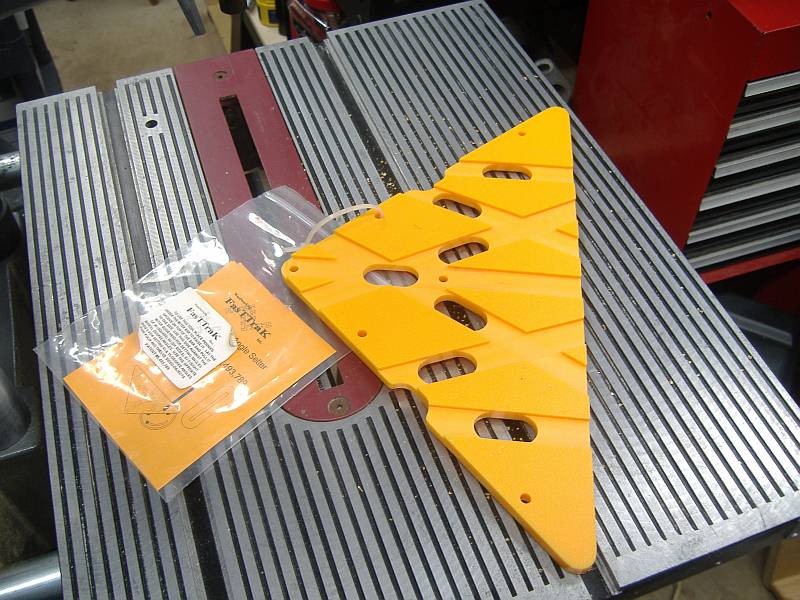

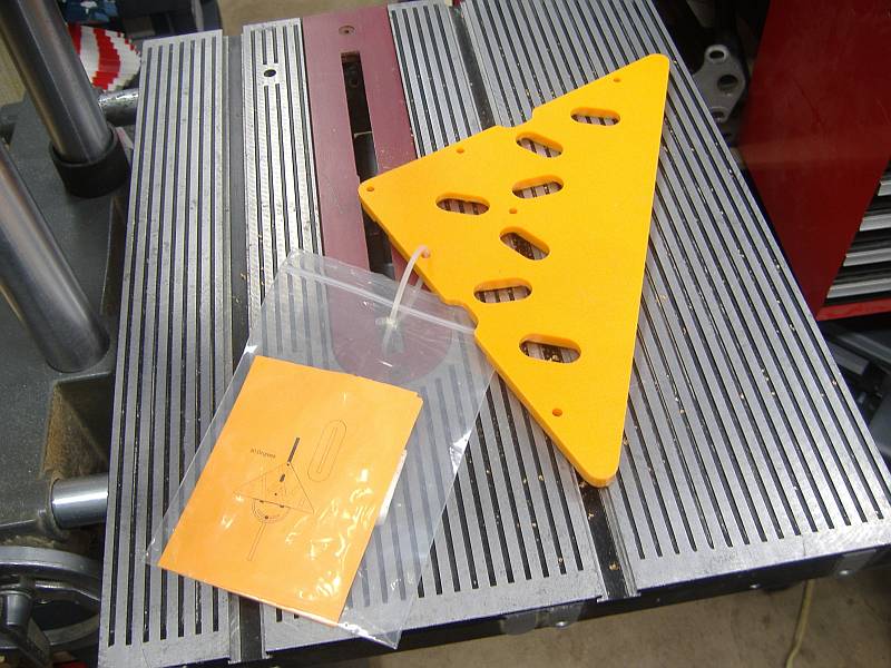

This winter I was starting to look at things and spotted this again. I had not even open the plastic bag with the instructions, it was cable tied to the gauge in a plastic bag. I figured I take a moment and read what it said. Well to my surprise the miter slots are oversize by design and even a stock miter gauge will fit loose... in other words it was designed to work this way and the shopsmith miter gauge size was not effected!
OK it is cold in the garage but I just had to give this thing a try. IT WORKS!

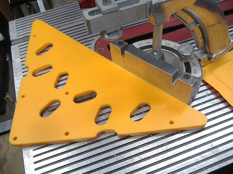

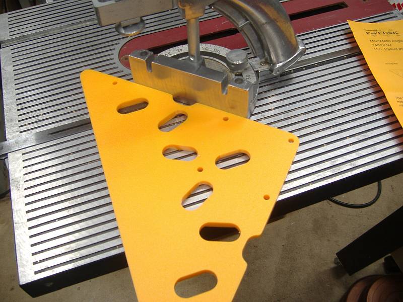

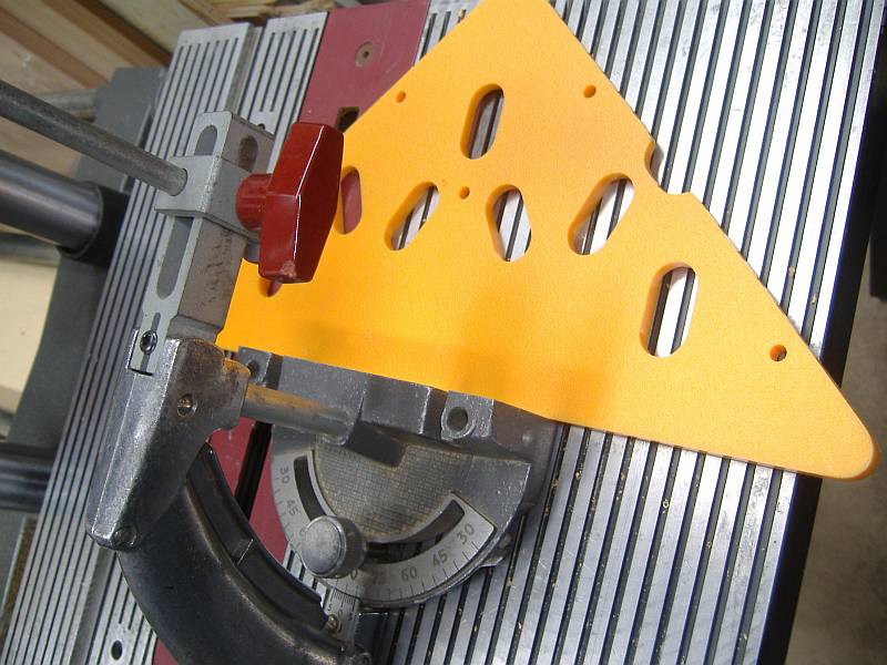

Now how about a few pictures so you can see what I'm talking about:
[ATTACH]6899[/ATTACH]
[ATTACH]6900[/ATTACH]
[ATTACH]6901[/ATTACH]
The FasTTrak name might ring a bell for a few of you. They marketed this system and then sold out to Kreg, so some of you may even have this system in use. The inventor is Mark Duginske who some of you may know from his bandsaw book and videos... well that and a few other items.
The patent can be seen at:
http://www.patentstorm.us/patents/5493789/fulltext.html

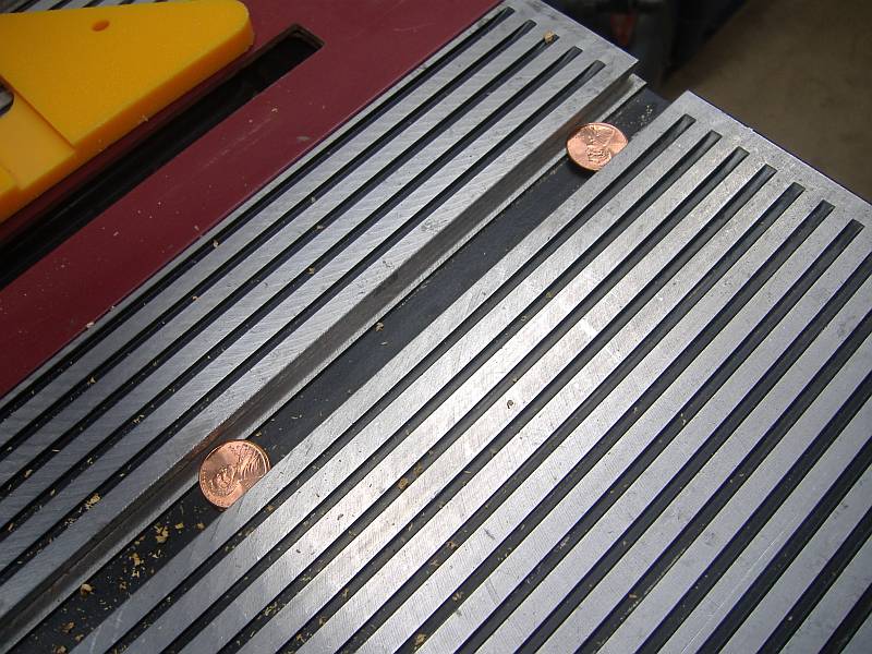

So with that taken care of lets dig into the details. It is designed to set the miter gauge at 15, 22-1/2, 30, 35 and 90 degrees. The grooves were CNC routed to better then one thousandth of an inch. And as I mentioned the grooves are wider then the miter bar.
To use it you place pennies in the miter slot to raise the bar just above the table. The gauge is then pushed against one side of the miter bar and with the miter gauge head loose you simply slide them together. At this point you tighten the miter gauge head and you are done. You should of course check a second time to make sure you didn't move anything while tightening the head.
[ATTACH]6902[/ATTACH]
[ATTACH]6903[/ATTACH]

I wanted to post a couple more pictures and to add a few more comments so this post should conclude the review.
I'll not post post all the possible angles but I wanted to add two more from a different prospective. One of the things that you need to take into account is the new shopsmiths use a t-slot washer which limits where you can have the miter bar raised. Not a big deal but something to remember.
[ATTACH]6904[/ATTACH]
[ATTACH]6905[/ATTACH]

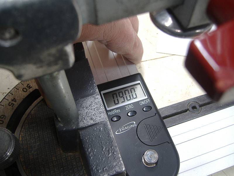

So now I expect you expect me to do a check of how accurate the setup was. At 90 degrees:
[ATTACH]6907[/ATTACH]

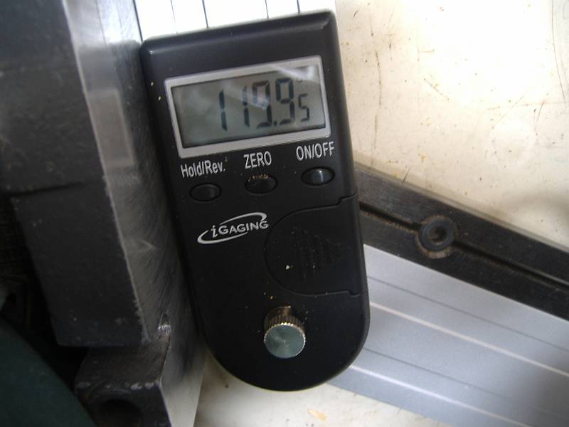

At the next setting you have to take away 90 degrees from the tool measuring the angle.... miter bar is zero, gauge is reading 119.95 degrees so it has gone past 90 degrees by 29.95 degrees or if you want it is short of 30 degrees by .05 degrees.... you would be way off on a moon shot but for most woodworking this is more then fine enough.
[ATTACH]6908[/ATTACH]
Wintery (opposite us summery), is if you get a gift don't wait 9 years to try it out... and not every thing is as clear as you might think it is when it comes to tools like this and a shopsmith.
