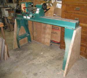

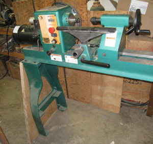

I saved these pics from a Craigslist ad. seems like you could make a folding saw horse with legs like these stabilizers to go under the bench tubes when you want to raise it. could even build a dust collection chute into the back and under the tubes.
[ATTACH]6974[/ATTACH]
[ATTACH]6975[/ATTACH]

- Grizzley_leg.jpg (9.82 KiB) Viewed 3103 times
- Grizzley_leg2.jpg (8.66 KiB) Viewed 3100 times

for lathe operations, you have to worry about both top heavy and about the effect of turning objects that have their Cg seriously off-axis. the legs in the pics I posted widened the base without increasing the height. for raising a SS and having it permanently on casters, I think that the caster's minimum separation (both wheels pivoted inward) needs to be more than the 19" of the SS feet.paulmcohen wrote:With casters and a lot of height I would worry about the machine being top heavy and too tall for most non-lathe operations.
as for non-lathe ops, since the goal is to get the lathe spindle to ~elbow height for the operator, seems like it might be too high for the table saw and planer ops but that most of the other operations would be adjusted properly for the operator (and the headstock would be closer to the hinge for the same height off the floor for vertical drill press work so easier to raise & lower without a lift assist).
sounds like a good reason to get a 2nd SS for table saw and sharpening of lathe chisels with the strip sander.
