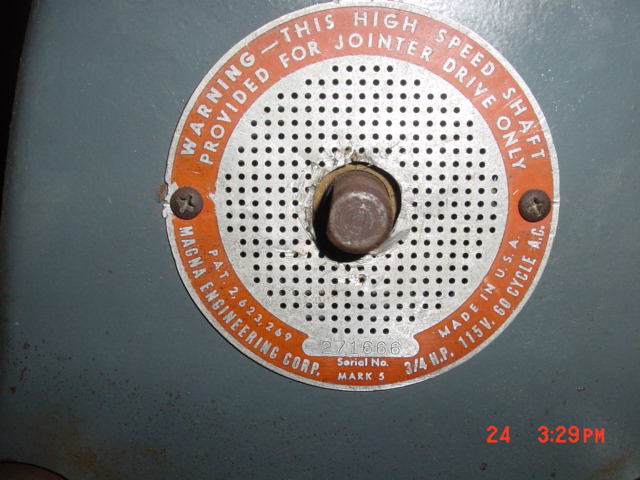

I am looking at another shopsmith to join my two Greenies, 1954 and 1956. It's a listing with a poor picture. The machine is grey and the owner tells me the serial number is 27166. I looked at the shopsmith serial number listing and couldn't figure out where this one might fit in. Any ideas?

It looks like it was made in June or July of 1954, according to the table at the bottom of the page on the following link:

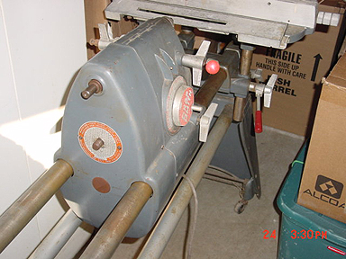

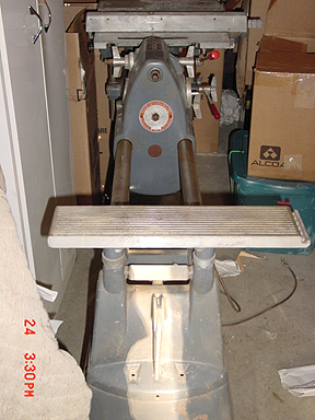

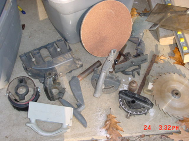

The owner of the shopsmith sent me some pictures, it must be a greenie painted grey, can't think of any other explanation. The tag indicates a 3/4 HP motor and the serial number indicates 1954. Can anyone identify the accessories in one of the photos? Or have another idea on this? I have two 3/4 hp shopsmiths so I will probably pass on this one.

Lathe tool rest, disk sander, fence straddler.
beeg wrote:Lathe tool rest, disk sander, fence straddler.
You might want to drop the motor and check out what is really inside. You may be able to see the motor name plate through the medallion hole. It may be 1 1/8 hp!
I do not think the sn plate is the 'original'!
The main table looks like a later version. That would explain the color!
The belt cover is from a later model.
The black thing is a mortise bit holder. The loopy things may be a part of a hold down. Neither are ss origin. The bit holder may be 3/4" not 5/8".
I doubt the 'extra' miter gauge will fit the table slots.
A drill chuck.
