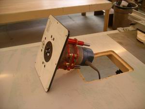

I was starting a custom kitchen and my Porter Cable died on me. With no time to send it in for service and fairly fed up with a marginal table, router and no lift system, I decided to upgrade.
After about 1000 board feet through the Woodpecker PRLV2, 37"x43" laminated table pre drilled and routed for the plate and the Incra Ultra Jig and Wonder Fence system, and a Milwaukee 5625-20 router, I can only say that I have been EXTREMELY pleased!
The lift makes it a breeze to change bits above the table. Height adjustment is a delight with the quick lift feature. And the fine adjustment wheel is a real treat. No interference or looking for a tool to adjust it.
The plate fits perfectly. Now, to me, that is saying a lot. I have never been able to get such a nice fit and finish between the table, the plate, and the insertion rings. The rings on this plate are super flat. Along with eight height adjustments(the screws sit on metal so not to dig into the mdf table!), it is the best I have used. The plunger on the side makes movement within the table non existent. I chose the Woodpecker unit because it was compatible with my PC insert bushings I already had.
After what I considered a short life with my PC, I am very happy with the perforrmance of the Milwaukee. 3 1/2 HP, variable speed, soft start, and great fit and finish. It has not shown even the slightest strain at half speed. I am looking forward to getting to the drawers and doors.
I will give an update after some dovetails and raised panel doors in the coming weeks. I am looking forward to it now the lowers and uppers are done.

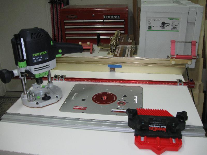

Well, I have been doing woodwork for many years. I have always appreciated German engineering and craftsmanship. I thought it was time to treat myself. I am glad I did. The Festool 1400 is the best plunge router I have ever had the privelage of using. It is hard to explain. I guess the best analogy is the difference between a Mercedes E63 or a Cadillac CTS-V. They are both terrrific sport sedans and some would question if the huge price difference between them is worth it? You just have to drive one to really know what the person is talking about.a1gutterman wrote:Welcome, timbertailor, and thank you for the report and picture. You did knot mention the Festool plunge router though...
There is an Achilles heel of the Festool routers. They are not well supported by third party vendors. So, I do not recommend it for table use. This makes thier lofty price tags a lot harder to justify. On the otherhand, a dedicated plunge router gives my shop more versatility.

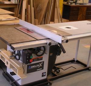

If anyone is contemplating a first time router lift with dedicated table I would recommend giving some thought to installation in your tablesaw. You get a huge work surface and you save duplication of precision fence components and space. I'm sure I've seen good adaptations of this idea to SS on this forum.

At any rate whatever kind you get you'll love your router lift.
Paul M
