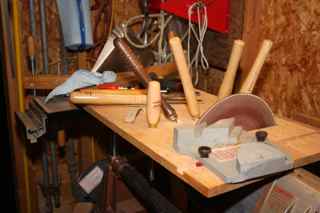

I used to agree about the breakdown needed for the sharpening guide. Based on someone else's ideas I did some modification to the mounting design. Used a long, wide piece that was miscut from an earlier project, and routed a dado for the Guide bar and a slot for the disk. Mounted sharpening paper on the hub side of the disc. Yes that means cutting a hole in the paper. Mount disc to left upper end of headstock. Clamp board to extension table mounted in left end sockets and lay board over disk. [ATTACH]7214[/ATTACH]
Works very well, just a half step left, adjust speed and sharpen.
I also use the normal side for a few items that need freehand work. [ATTACH]7215[/ATTACH]. One of my changes was to add some holes for storing chisels for quick tradeoff.
I have even learned to use the Sharpening Guide to put a slight belly on the skew by rocking it in the guide a little. This helps me because I haven't mastered the straight angled skew. [ATTACH]7218[/ATTACH] Not much belly, but enough to reduce my catches by about 80%.
