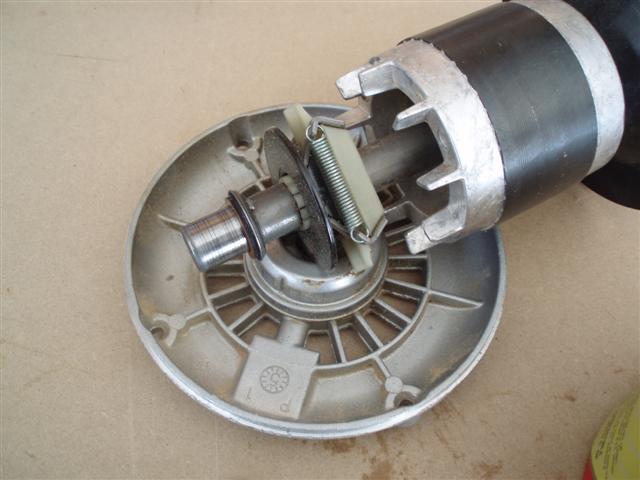

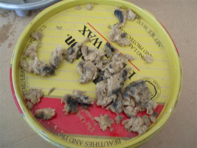

[ATTACH]7220[/ATTACH]
A cotton like material just soaked with oil and packed in around the "bushing"
[ATTACH]7221[/ATTACH]
Nothing Special

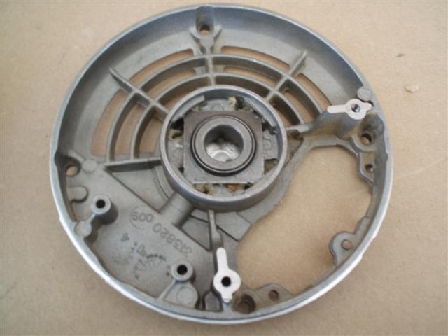

[ATTACH]7222[/ATTACH]
The square bearing

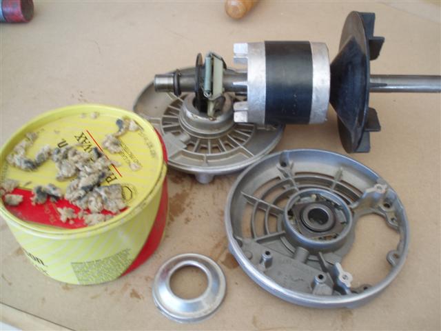

[ATTACH]7223[/ATTACH]
The whole mess
Now I am trying to pull the external cover off one end of the motor to get a look at the inside of the square bearing.
I would advise that you check all of your motors to see if they have oil application ports.

As always, it is important to read the manual (I sure had not). From the Crafter's Station Manual:
"The motor needs lubricating. You should oil the motor according to the directions on the motor label. If your label is missing or unreadable oil your motor after every 50 hours of use with approximately 1 tsp. of SAE 20.
1. Remove a yellow plug from each end of the motor.
2. Place appropriate amount of oil in holes.
3. Re-insert yellow plugs."
My Power Station manual indicates that NO lubrication is necessary. Though I will inspect the motor the next opportunity I have. Hope this helps.
