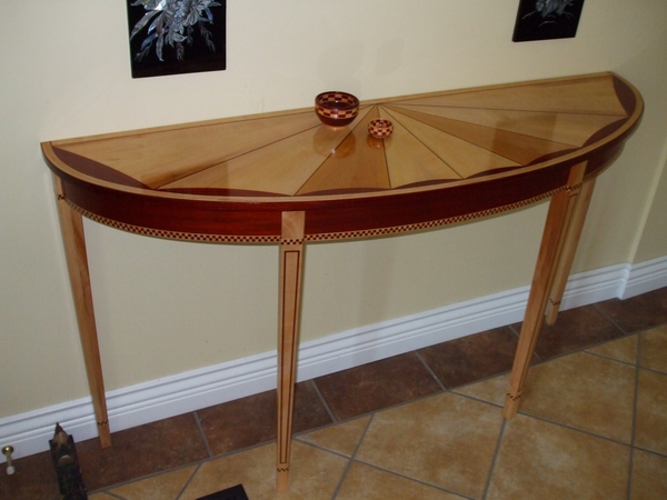

I have had one very much like the American Woodworker one and have used it to dry many locally scrounged hardwoods. They work amazingly well and I get to make things out of species no one else has access to. Do be careful to balance the collector area with the amount of wood you are drying. Mine handles about 200 fbm. The first time I used it I only had about 125 fbm and I had a little overdrying occur. All you have to do is cover some of the collector area. The trick is to balance so that the moisture is being evaporated from the surface at the same rate that is is migrating to the surface from inside. Sounds technical I know but trial and error will soon have you confident enough to dry anything.
This table is made from Arbutus that came from a huge trunk of a forked tree by my shop. When I built the shop one trunk had to go. Now it lives in our front hall.
[ATTACH]7269[/ATTACH]
Drying your own wood can be very satisfying.
Good Luck
Paul M
