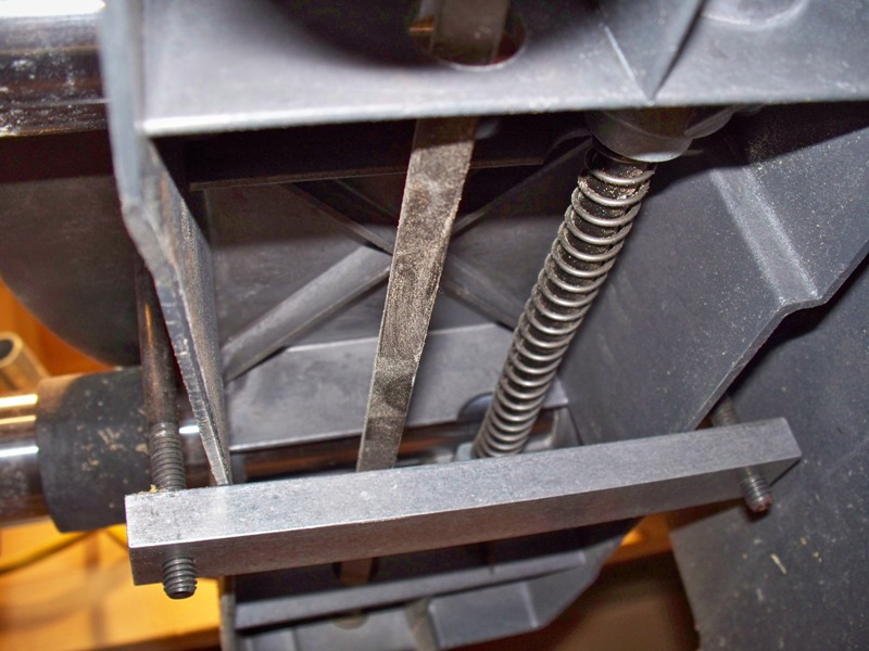

The UTR has two bolts and a long flat bar that secures it to your carriage, after removing everything else, without drilling holes.

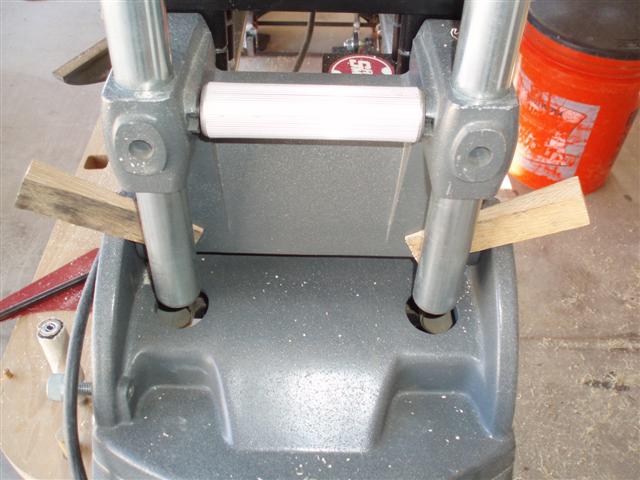

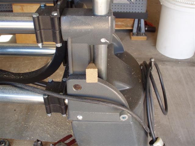

Paul doesn't see his head rest flexing so maybe I don't have myself tuned in properly to what is being asked.
I believe may head rest does flex. In fact, every thing that I install in that end of the Mark V moves, in an unwanted direction, if pressure is applied.
The pictures that I have included here are not of the head rest; these pictures are of the extension table installed at that end of the Mark V but I stabilize the extension table the same way.
[ATTACH]7551[/ATTACH] [ATTACH]7552[/ATTACH]
The extension table when installed at the other end doesn't move. I have plans to turn a couple collars to be used in place of these wedges.

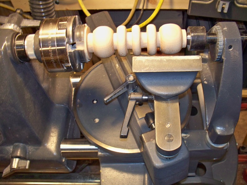

I have the universal tool rest mounted on my SS right now as am in the middle of turning a baby rattle. I took a couple of pictures to show how it is mounted. I have a 510 converted to a 520 so not sure if the carriage is the same as what you have. There are two holes on the base of the tool rest which two long allen bolts drop down to an aluminum bar which has threads which the allen bolts tighten into. The pictures show the top side and what it looks like from looking up at the bottom side. Hope this explains a little about your question as far as how it mounts. I have had it for several years now and don't really have any issues with vibration or such. I have the speed reducer if I need to go to a slower speed for a large bowl or large stock but for my smaller projects I generally try to round my stock on the band-saw[ATTACH]7553[/ATTACH]
[ATTACH]7554[/ATTACH] as much as possible before I start turning it. Hope this helps.

paulmcohen wrote:The flex you are seeing has to do with the long post, when turning there is no long post sticking down below from the tailstock. There is already a collar on the tailstock and I use two one on each post and that may be preventing the flexing.
You are absolutely correct, Paul but the flex does still exist. Install the tailstock and grab a hold of it at the top and push and pull. Do you can feel any movement?
If no, then I am absolutely wrong. If yes, I might still be absolutely wrong. Maybe that movement (it is slight) is of no consequence. I am not a turner (though I do use my lathe from time to time) so maybe I just do not get it.

I will try to get some pictures of the different stages of making the rattle and post them when I get them organized. As for how big of a bowl can you turn with the UTR, I am not sure but I would think that it would not reduce too much the diameter compared to without using the UTR. I really like using the UTR as it makes it so easy to adjust the tool rest to different positions and I would be lost without it.
