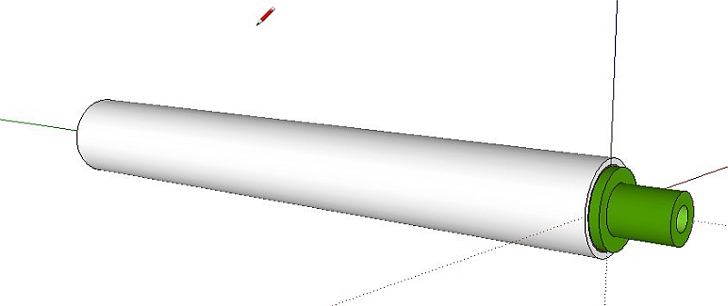

I knew a few of you would come up with some ideas, that is great and who knows maybe this will help someone else on another project or someone looking for a way to accomplish something.
I'll post a bit of how I'm planning on using this from my sketchup drawing.
[ATTACH]7731[/ATTACH]
- 18 inch drum.jpg (55.61 KiB) Viewed 2912 times
