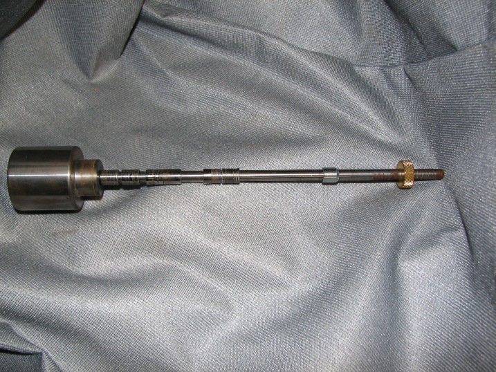

I purchased my mandrel with the adaptor for SS from PennState. Attaching a couple of pictures what it looks like. This is a 7mm one for slimline pens. Excuse the rust on it, as I use it for both wood and acrylic and you use wet sanding pads for acrylic, thus the cause of the rust. I better clean it up before showing it in a photo again. Hope this info helps you.
- Mandrel 1.JPG (208.96 KiB) Viewed 5476 times
- Mandrel on SS.JPG (147.19 KiB) Viewed 5610 times
Ron from Lewisburg, TN
