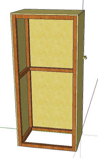

I've used OSB for several projects. It is not like plywood and trying to make something out of just OSB may not be a good way to go. But if you have the OSB or like the low price or just want to see how it works then you might want to think about it working in a different way. As an example I have seen a lot of crates made using the material by having either in internal or external skeleton of real wood or plywood and the OSB as a sheeting.
I did a quick sketchup drawing of it with an internal skeleton of 2x2's. If you want some more help on the how to do this I can draw up how the doors might be done by adding some 1x4 strips to OSO panels....
[ATTACH]7868[/ATTACH]
- osb cab.jpg (27.22 KiB) Viewed 12721 times

I have used OSB for a lot of stuff. I find that the OSB produced today to be far better than that produced 10 years ago especially where exposed to weather. I have used it to build tool stands etc. and it worked fine. In that case I did like Ed showed in the sketch above but used ¾" X ¾" stock. I sanded the surfaces that came together and glued it all with Gorilla Glue and nailed it from the outside with an air brad gun. Based on those experiences I would have absolutely no qualms about building shop cabinets out of it. I do believe that I would use something else for the doors.
