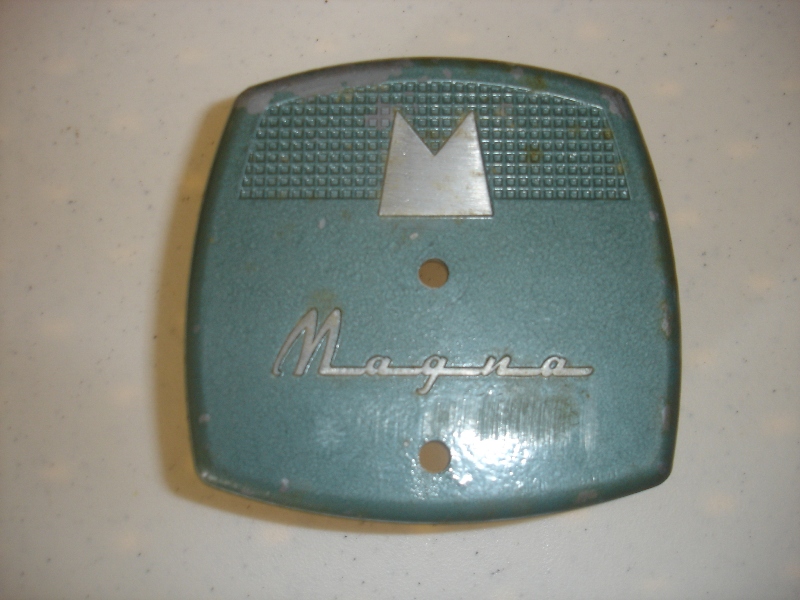

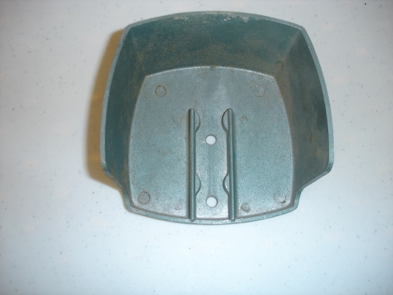

I got this cover with a Greenie jigsaw and I'm pretty sure it doesn't go on the saw. Can anyone tell me what this cover goes to? Thanks.
Jayhawk

jayhawk wrote:I got this cover with a Greenie jigsaw and I'm pretty sure it doesn't go on the saw. Can anyone tell me what this cover goes to? Thanks.
My guess would be a cover for the pulley on the jig saw shaft and belt when the jig saw is mounted on a stand. You are missing the mounting hardware.

Post by Collector »
Hello:
Bill Mayo is right, it is a pulley cover, and a nice one! The new (and current) ones are just gray plastic.
The picture suggests that the current cover's hardware will fit your cover, Take a look at the current catalog.
