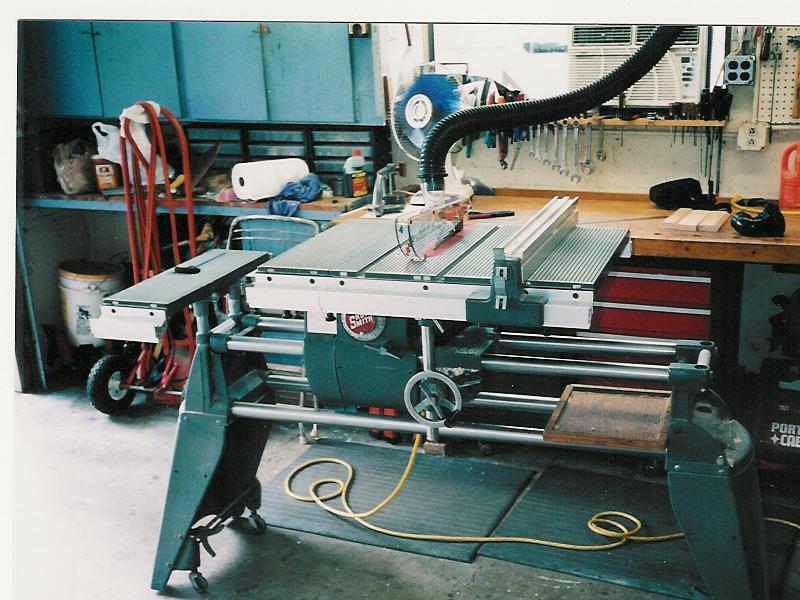

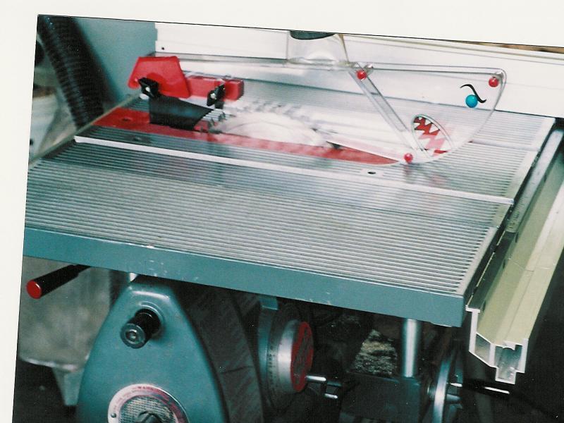

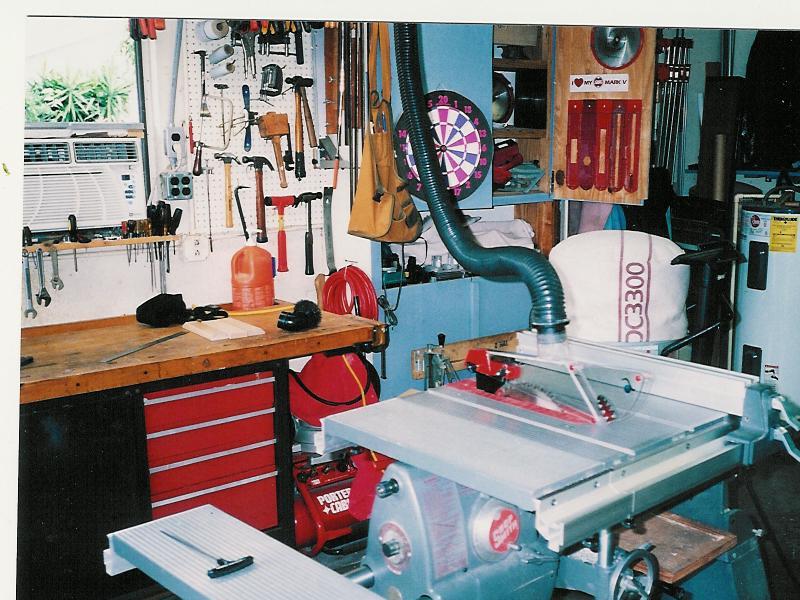

I got the latest Sharkguard for a SS mounted on my machine.
See included pictures
So far with limited testing it seems to do everything it promises. I cut various wood and it caught most of the dust. I even did a shaving cut on MDF (produces a bunch of dust) and none excaped the Shark.
The thing I like best is if your doing a non through cut you can remove the blade guard and it mounting and still have the riving knife. Mounting and removing just the blade guard is nothing more than losening the two wing nuts and flipping up the keeper and pulling it off. Of course the whole assembly mounts to the SS just like the original blade guard.
Lee Styron is a super guy to work with and goes out of his way to make things right.

Hi Ed,
That looks good! Keep us posted of pros and cons after you've had a chance to 'put it through the wringer'.
Also how much $$ ? and where to get it?

Lee now has them listed on his site.
http://www.leestyron.com/sharkguard.php
The fact you now have upper and lower dust collection improves air quality and I think the thing adds to the looks of the SS.:D

It seems the Shark Guard is made of a more see-thru plastic than the original Shopsmith guard. I wonder if it will stay that way since the dust is being removed as it's created? One of my complaints with the SS guard is that it gets dirty and I can't see the cut line when in use.

It looks like a nice setup but maybe just a bit over priced.
