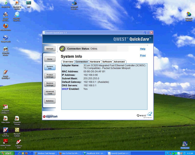

I have learned that on my end of this discussion, my ISP (QWest) maintains my IP dynamically.
[ATTACH]8194[/ATTACH]
So I guess the remaining question is how/where is "shopsmith.net" resolved to an IP address.
Whenever I am unable to reach the forum, if I do a trace using VisualRoute 2010 I find that the IP address for "shopsmith.net" cannot be found.
- My DNS System Info.jpg (207.66 KiB) Viewed 7024 times
