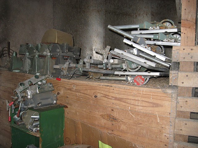

JPG40504 wrote:A word of caution! Do not assume anything relative to what/how old/model you are dealing with. It can be a mix from different units.
Do you mean like from my parts stash? ]8344[/ATTACH]
- SS stash2.JPG (88.25 KiB) Viewed 6842 times
And that does not include the stable of operating ones!:DPG-Zac wrote:WOAH Francis !!!![]()
That is quite a stash - you certainly have one or two spares.
