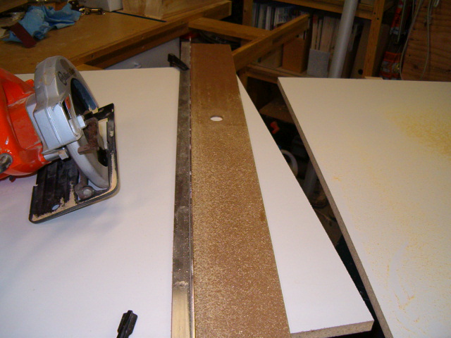

Mine is a piece of "L" aluminum. Screwed the long leg to a piece of 1/2" BB ply then ran the circular saw along the guide. Left about two inches on the "other side" of the aluminum for clamping. By sawing the ply, there is no need to figure offsets for the saw shoe.
Gene
Here's mine - works good! It used to be 8' long, but now is 4'. I found a little bow at about five ft. so cut it down. The aluminum angle iron had to be trimmed to about 1/2" high after screwing it to the hard board. The trimming was necessary to allow my saw to get deep enough to cut through 1" deep. The hole in the har board is for hanging it up. (very expensive saw - bought it at a pawn shop for $25)
[ATTACH]8347[/ATTACH]
straight cutting guide.jpg (118.59 KiB) Viewed 3100 times
