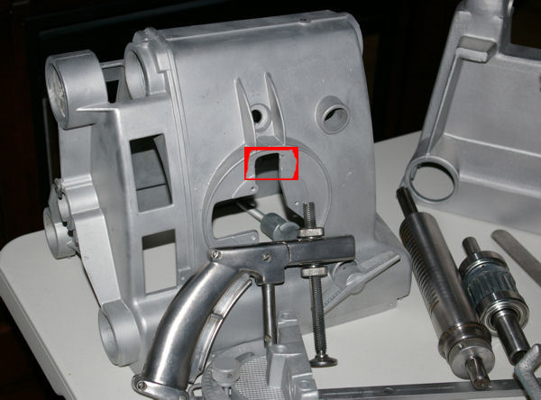

These are just some stuff from my rebuild so forgive please the roughness of the photos.
The first shows my headstock casting. The red area is where the spring goes.
[ATTACH]8449[/ATTACH]
and this is an attempt to zoom in on that area.
[ATTACH]8450[/ATTACH]
The spring spans the gap into the back of the speed ring. Pushing on it to reduce the rattle as I understand it.
