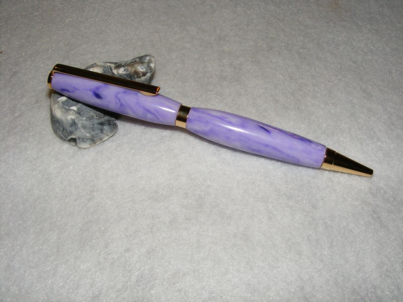

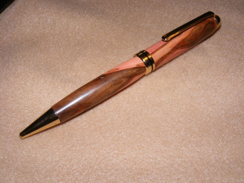

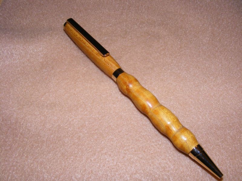

I got that set the last time they went on sale, To answer your question from me I still use my large set since I am use to them. The smaller set works fine as you get better and want to do more detail. But I don't think it comes as a have to to turn pens. Here are a few I turned with the standard SS set.
But just an opinion.
- Mountain Mahogany.JPG (106.01 KiB) Viewed 3808 times
- Osage Orange.JPG (110.36 KiB) Viewed 3804 times
- Purple -1 (3).JPG (74.55 KiB) Viewed 3810 times
