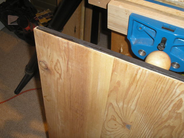

Here was a case where I tilted the Mark-V-mount OPR table to the horizontal mode. (Like the old Jointmatic machine, basically.) I used a small 1/8" bit to rout some channels in the end of a glued-up board. I manipulated the glue-up past the router-tip such that the 1/8" groove always registered parallel to the (bowed) board surface. Then, I fitted in some steel bars, which serve to this day as "ultra rigid breadboard ends," for a straight assembly across the seasons:

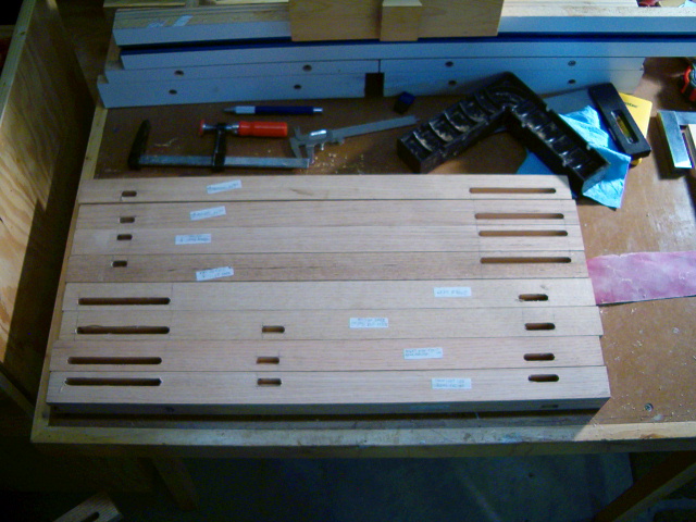

The OPR is the very best mortising machine I can think of. Through mortises, stopped mortises, even stub mortises. These can be done in either the vertical or horizontal mode. Tenons are also doable on the OPR. See Sawdust sessions!
Ed (reible) has posted how to make mortises on a router table, but my opinion is the OPR is easier and maybe more accurate. (At least for a person that has little experience with a table router.) As, said - old habits die hard because they get ingrained (no pun intended)

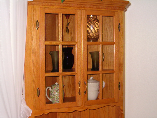

My OPR has produced glass door frames and muntins. Of course, edge routing is a snap also! Of course I don't want to forget raised panels!

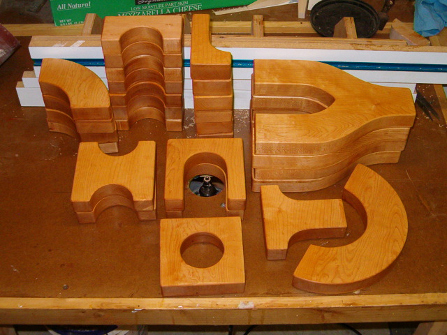

Yes, I've also done some pattern routing - making unique shaped play blocks. In the attached photo, you can see I elected to use the router table to use a 1/16th roundover for the sharp edges.

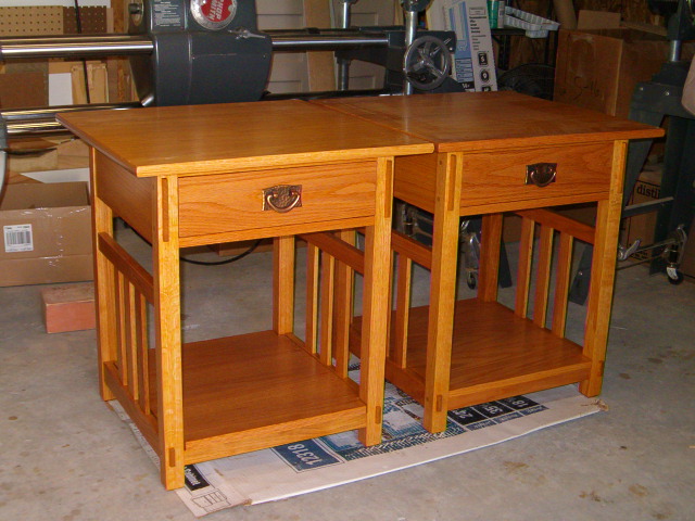

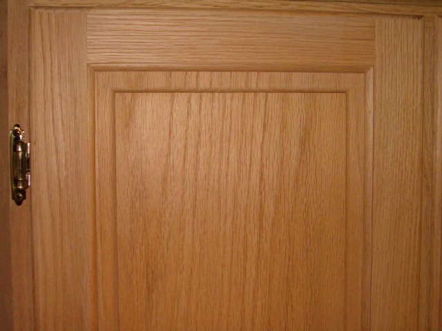

Here's photos of some of the work --
