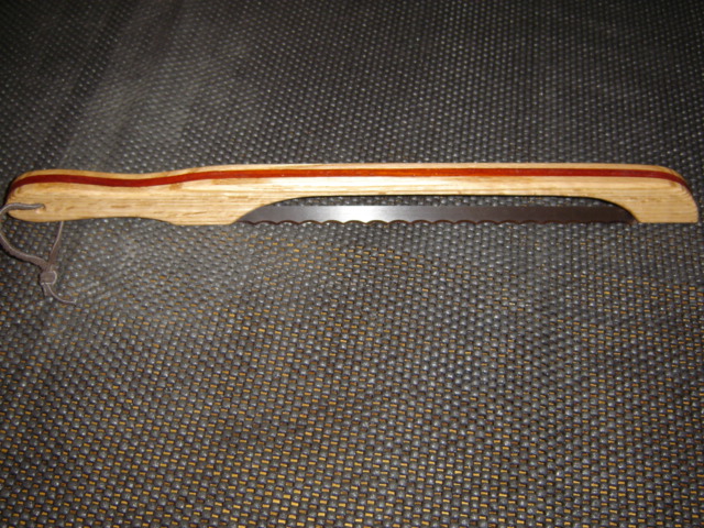

I finished a bread knife that should look better than it does. The woods are padouk sandwiched between two oak pieces. Since the oak has open grain, sanding allowed the dust from the padouk to collect in the open grain. Even though I dusted the finished knife well. Some dust remained, unseen of course. When I wiped on the first coat of poly finish, there were slight traces of the orange colour in the oak. Each succeeding coat seemed to cause more colour to bleed from the padouk to the oak. I have used this combination before without this problem but I suspect that because the exposed surfaces were end grain, they did not absorb the colour in the same way. I guess I should have vacumed my piece before finishing and used a spray finish instead of wipe-on.

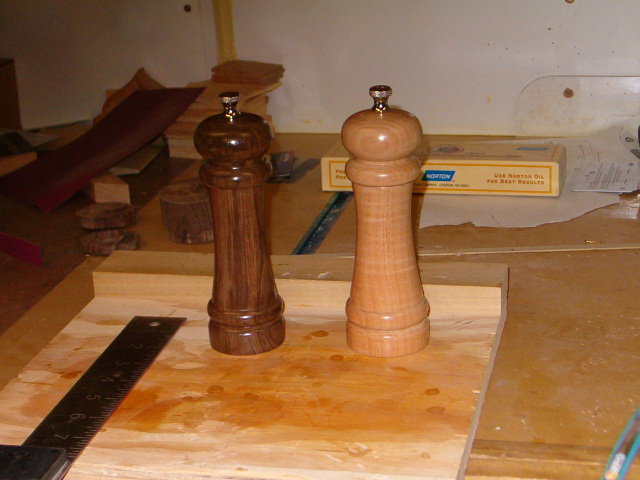

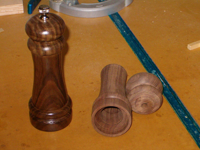

This week, while waiting for our mini van to get out of the shop - I had no way to pick up wood - other than what would fit into the VW new beetle. So didn't even try to get any poplar for the shutter project. Instead took the pieces of walnut that were purchased (and drying) since last November and turned a couple of pepper grinders. [ATTACH]316[/ATTACH]
These were 2 1/2" blocks that were supposedly dried prior to purchase. I had turned them down to 2 1/4" cylinders and they were wet!! My moisture meter was pinned at 22% and didn't show any reduction until May. Since they were now down to 8% near the ends to 18% in the middle. The meter only measures 1/2" deep so I suspected the centers of the cylinders would probably be wetter. Since the centers would be bored out I decided to go ahead. They turned O.K and the boring chips from the cores felt quite damp. Looks like they will hold their shape and not crack. The salt grinders of the two sets were made for Christmas presents. Now the sets are complete. [ATTACH]317[/ATTACH]

Nice looking pepper mills. Did you use forstner bit to bore them out? Also curious about what you used for the final outside finish. In reference to the shuttle, I used to live in Palmdale about a mile from plant 42 and used to watch them come overhead making the turn before they landed at Edwards. Sonic booms were really house rattling.

To rkh2 - Yes, used Forstner bits for both the counter boar and the through boring. The finish is Rockler "Wunder Coat" semi gloss. (67790 for 16 oz.) Damn - it's expensive, almost a penny an ounce, but it's worth it. Has a slight amber cast, which I like for a water borne polyurethane. It smooths out nicely on any surface with a sponge brush and dries real fast! After 3 coats, rubbed the grinders down with one of those blue shop towels.

To Allen - Yep! The grinders came from a Kit recommended by Wood Magazine.

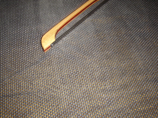

Here are a couple of shots of the bread knife, it must have moved on the second one, I know I didn't! One again, the photography is not good. I can't seem to avoid the flash effect.

John! Nice looking bread knife! I was a little surprised to find the oak looks beautiful and natural. I thought there might be some interesting red stains in it. Even enlarged your photo to 150% and still looked like oak to me! Nice job!
If either of you guys are serious about turning out a 6" pair of salt and pepper grinders. Here is the link to the company; http://www.woodturnerscatalog.com item number 965-6666 / Peppermill kit (Wood Magazine) The kit comes with the grinding mechanisms (nylon for salt & Stainless for pepper) You have to be careful not to order too much since the kit comes with one long shanked 1 1/16" and one regular 1 5/8" forstner bits.
I had two problems with doing these: 1) The walnut was very wet and took 7 months to dry out enough in this desert low humidity. 2) drilling the core was very difficult to do without a lathe chuck. I used face plates and had a hard time re-aligning them when switching ends. If you are serious - buy an adjustable chuck now.
The Price for 4 mechanisms, 4 wood blanks (2 maple & 2 walnut), including the 2 forstners was $83.82 including shipping and handling.
The turning isn't difficult. I am not an accomplished turner by any means and did the turning without problems. An adjustable chuck makes the boring a lot easier. (I got the Oneway Talon from SS).

The discolouration is more on the top. My wife says it 's OK, people will think it's the grain but you know the feeling, "I know it's there". Otherwise it does look OK and the contrast is neat.
I will be trying more with different contrasting woods to try to sell them in the Christmas craft shows. If not, a couple of my children have already been warned thery will be getting bread knives this year.
