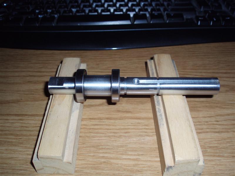

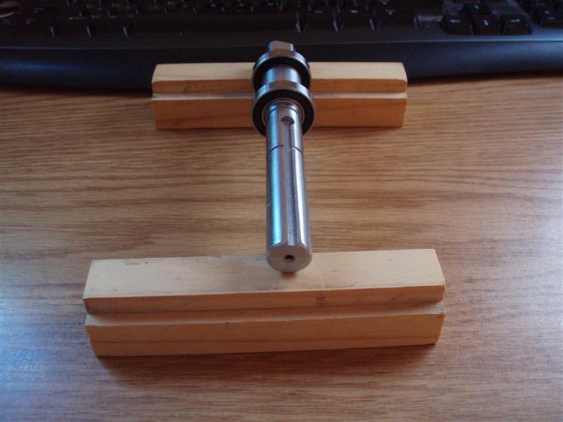

Shopsmith has introduced a new part. Do you know what it is? What do you think about the new design?

What's it for?
BPR
That was the first question. Do you know what it is?
If I answer your question now....well, let's let it go for at least a little while.
Hint: It is a replacement part.

Dusty-
O.K. Well, looking at the left end, it looks like an extension for the quill on the headstock. But the serrations on the right appear similer to what allows the lathe rest ride up and down in the table carriage. But I'm going to go with my intuition ( which is to guess) and say it has to be a replacement for the idler shaft in the headstock. Is that even close?

Well....yes, that is about as close as you could get.

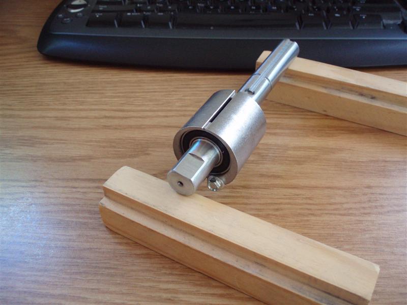

It is an Idler Shaft Assembly. I originally ordered an Idler Shaft (5041789) and a small assortment of parts to be used along with the idler shaft. I called Shopsmith to follow up on the order and found that delivery was delayed because the Idler Shaft was under going a redesign. This is the result of that redesign. There are two bearings and the shaft is built so as to properly position those bearings at the edge of the Eccentric (perfect fit). Can't go wrong. My favorite kind of part.
This is the new Idler Shaft Assembly, 522741.
Recall that the old Idler Shaft could not be rebuilt because the bearing was an integral part of the shaft (the shaft was the inner race). The new part sports replaceable bearings. The bearings are 6903RS (17mm x 30mm x 7mm).
SIDE COMMENT: I am pleased to know that Shopsmith is still redesigning parts for the existing models of the Mark V. I feel this is a GOOD indicator of Shopsmith's long term intentions. I don't believe the PowerPro will have an Idler Shaft.
