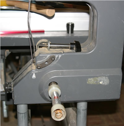

Here is a pic of the strip sander with the table removed and the chisel platen installed.
[ATTACH]8797[/ATTACH]

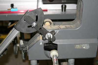

Here is with the guide installed.
[ATTACH]8798[/ATTACH]

peterm
Posts: 576
Post by peterm »
ahh, now I see how it mounts! It was the fact that it has an arm to stand it off from the ss that I was not getting.
