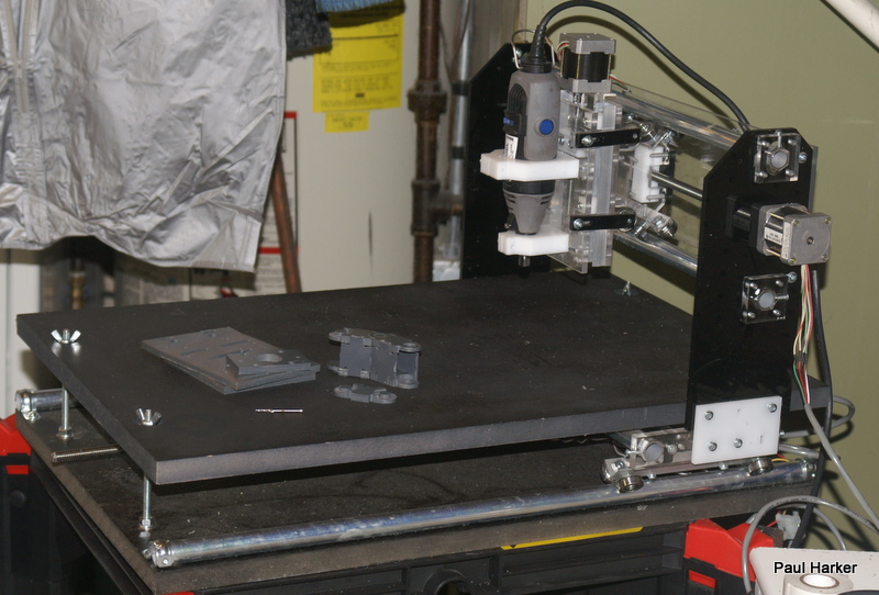

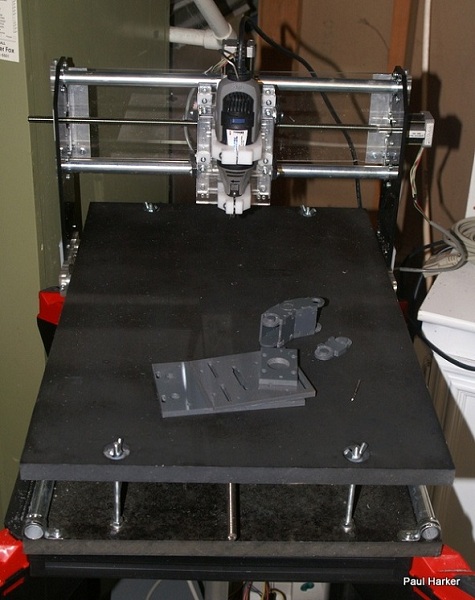

A few pictures -- Here is a mostly stock BluumaxCNC.
Sitting on the worktable are a few parts I made using the Bluumax. The flat plates are for my Z-axis upgrade and the smaller parts are for a cable-carrier chain.
[attach]8951[/attach]

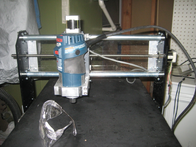

And from the front --
The plexi plate running across the back supported by two pieces of aluminum angle were my first mod. It significantly improves the rigidity of the gantry.
I made the dremel holders as my first project. However Bluumax now includes one set of Dremel holders with the kit.
-- It occurs to me that I did not make it clear that the Bluumax comes as a box of parts. You must assemble it yourself. It took me about an hour, not including the MDF purchase, cut, paint, and drill.
[attach]8953[/attach]

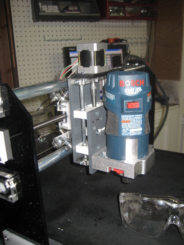

A side view of the updated Z-axis
This mod also had the advantage of bringing the center of gravity back so it is better centered over the long axis (X) support bearings.
[ATTACH]8954[/ATTACH]
Future dreams -- to replace the z-axis upgrade plates with aluminum to reduce flex.
