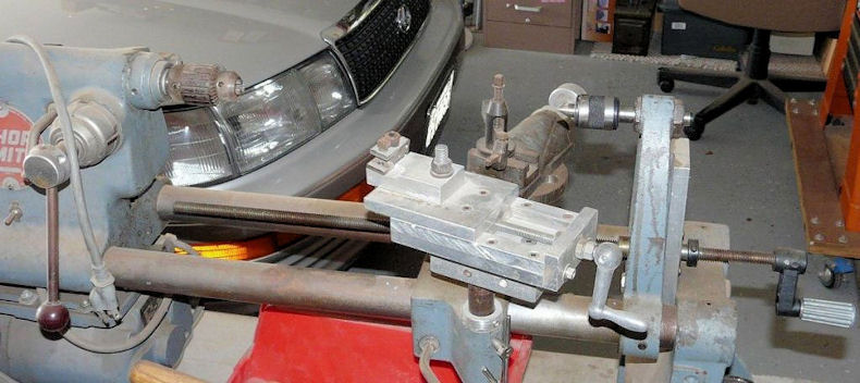

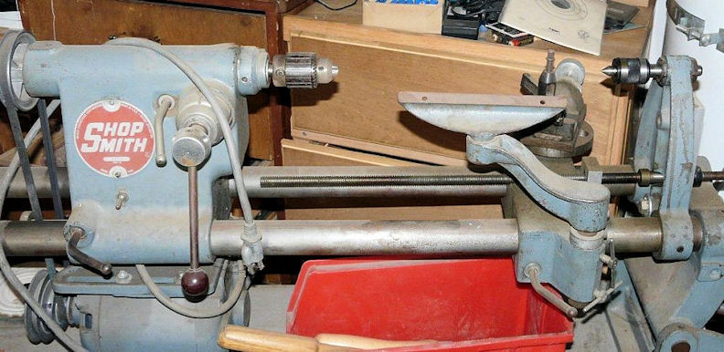

Has anyone seen a design for a Shopsmith Carriage drive. I want to be able to move the Carriage with a hand crank smothly and wold prefer to not drill holes on my unit. I was thinking of using an Acme screw but the rest of the details I have not worked out. It looks like something could be done for less than $100.

Paul, I saved the following pics off a post about this topic but could not find it again. These may give you some ideas.
[ATTACH]9009[/ATTACH]
[ATTACH]9010[/ATTACH]

Peter that is exactly what I was looking for, now I need a few more details on how it was done.
