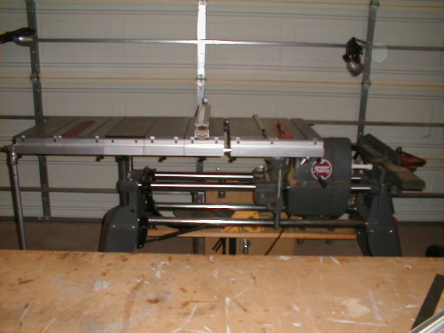

- Maximum Table Width.JPG (54.72 KiB) Viewed 14414 times
rookie error
Thanks for the picture, dusty, I understand now. I'm such a rookie I set up first for jointing, then sawing, rather than both at once. Obviously I need more practice. And I'm really looking forward to videos which hopefully willl demonstrate these sorts of time-saving concepts!

As stated before, you can setup for use of the jointer and table saw simultaneously and I often do.
However, I would feel remiss if I didn't issue a caution at this point.
Please be ever mindful that the jointer blades are spinning while you are using the table saw. Please make certain that the safety guard on the jointer is in place.
Likewise, don't loose track of the fact that the saw blade is spinning, hopefully not without a guard, while you are jointing. This is all especially important if you are not alone in your shop while you are doing all of this.
Whenever you set up for multiple equipment be aware that the speed settings may not be the same (in fact, probably are not the same). Do not operate at a speed higher than that recommended for the lowest speed accessory that you have connected..
