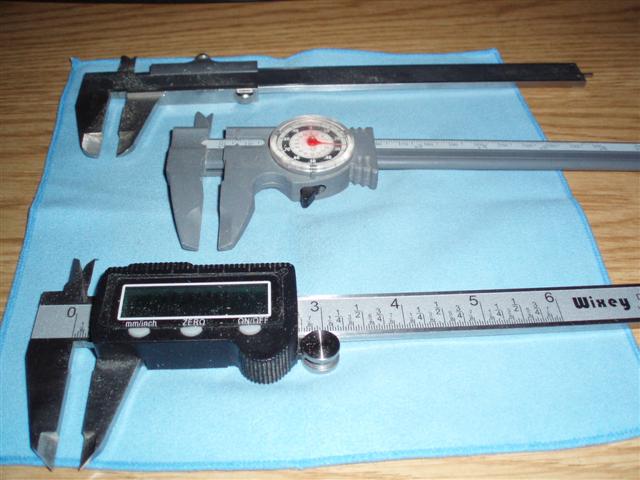

By the way.. If anyone wants to know the difference between the different types of calipers, checkout this page.. I've got a dial caliper as well but have no idea where it came from..
Rick
S/W of Los Angeles, CA
1983 Mark V model 510 (SN#140061)
Dial and Digital and Vernier
[ATTACH]9197[/ATTACH]
I use them all but I probably rely on the Digital from Wixey a little more than the others.
For years the only one I had was the Brown and Sharpe Vernier which I have had for much longer than my Mark V.
