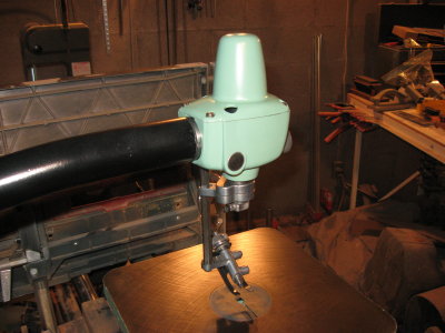

May not be the correct way but just restored an old Magna Jigsaw. I used a brass wire brush chucked in my Shopsmith. Cleaned all the old paint off the aluminum parts. All the parts were repainted. I would not wire brush parts to be left as is.
- IMG_0622_4.JPG (37.82 KiB) Viewed 6571 times
Really? Is it that the wire brush wasn't too harsh for the aluminum or that you didn't allow it to stay in one spot long enough to cause damage?
I could have sworn it looked like I was about to start causing wire brush marks in the aluminum, but maybe it was just an optical illusion of the metal cleaning up???
