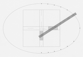

A recent airing of Roy Underhill's Woodwright Shop showed- quite briefly- a device used to draw or mark on a workpiece an ellipse as a guide for a faux inlay, and Roy called it (I believe) an "elliptograph".
I had seen such a device before, but it had been presented as a "do-nothing toy", a rectangle about 6" square or 6x8, with through centered cross grooves and an arm that was connected to 2 blocks that rode in the grooves and extended well past the extent of the base with a pencil in that end. The whole thing drew an ellipse by virtue of running the pencil around the base, with the blocks sliding in the 2 grooves (in 2 directions at once).
I thought that would be a handy tool to have on hand, so I made one on the SS, after drawing a working model in CAD to make sure I'd seen it right.
But then I wanted to fine tune the thing and make it easily adjustable and, well, presentable, and not wanting to spend a lot of time on a redundant designing of the rotating circular support mechanism, so to speak, I went looking for a model that hopefully had done the grunt work (geometry) for me.
Alas, I searched the fori hi & lo to no avail, and everywhere else I could think of.
Thus my query:
Anyone built a device for drawing ellipses such as I described or similar? Just looking to save the tedious work of trial-n-error testing of varied size pieces for the adjustable feature.
Basic unit from scrap pieces is 5" square.

You may be interested in one of the feature articles in the Lee Valley Newsletter I received today.
http://www.leevalley.com/en/Newsletters ... =160&lid=1
It is just what you are asking about.
Ron
Ron
That's it, more or less!RonKlein wrote:You may be interested in one of the feature articles in the Lee Valley Newsletter I received today.
Ron
Same idea, different approach, but the relationships I sought are there.
"... to fiddle with this process and make several,..." is an understatement, and exactly what I was looking to lighten up on.
This will be a great help. Thank you for the link.

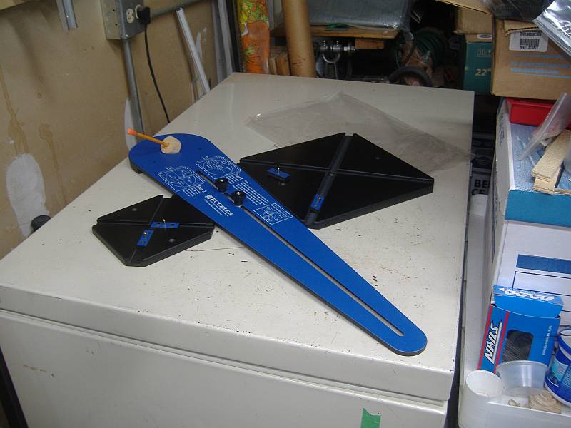

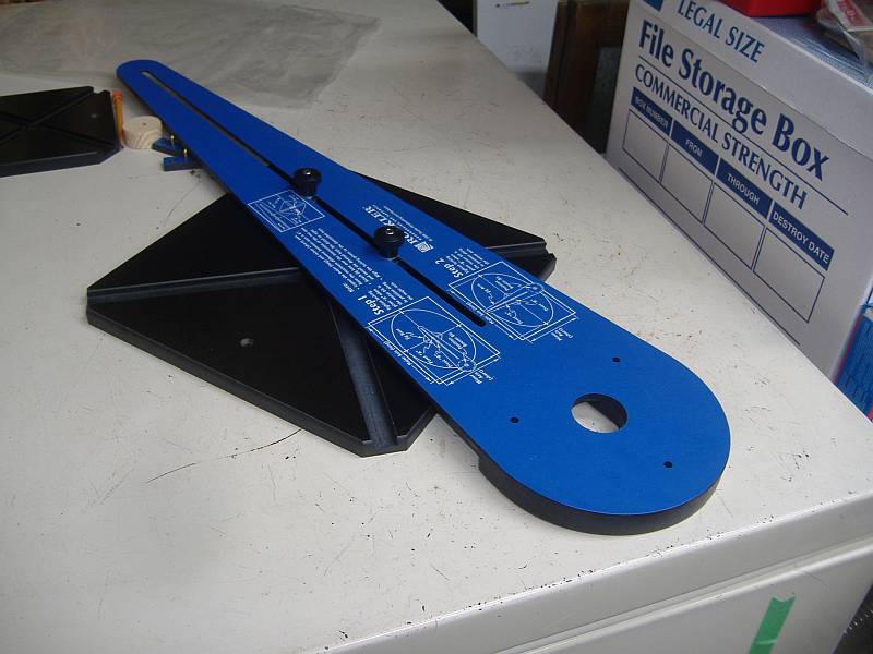

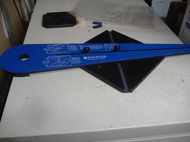

As a FYI Rockler sells a jig that is called an ellipse/circle jig and has a large ellipse base add on. It is designed to use with a router (std Porter Cable hole layout).
I have both parts:
[ATTACH]9602[/ATTACH]
[ATTACH]9603[/ATTACH]
[ATTACH]9604[/ATTACH]
I made a small wooden adapter that fits in the jig that will hold a pencil so I can see what the circle or ellipse will look like (pencil line would be in the center of the cut).
In use the router is attached to the pivot arm, the base is attached to the work piece center. Next the arm is adjusted for length (radius) of the circle or the major/minor axes for an ellipse are set.
There are limitations and it is quite costly but it is made of a nice phenolic material. (I have seen the small base unit on sale for half price not long ago).

The jigs can be found here:
http://www.rockler.com/product.cfm?page=17282&tagem=rv
http://www.rockler.com/product.cfm?page ... rcle%20jig
Thanks. Good visual references. I imagine since I wasn't interested in the idea the last time I perused my Rockler catalog I passed right on by it without a notice.reible wrote:The jigs can be found here:
