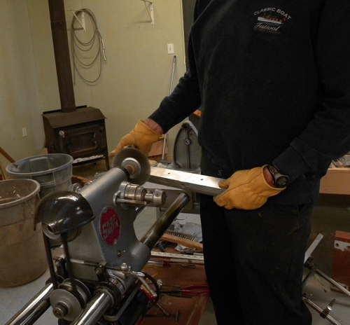

This works well but cover up including a face shield. Those little wires do get loose and turn into little darts.
[ATTACH]9841[/ATTACH]

shipwright wrote:This works well but cover up including a face shield. Those little wires do get loose and turn into little darts.
Paul M
Haha,
Yeah, I found a few of those little darts sticking out from my jeans after using my wire wheel, and shortly thereafter upgraded from protective goggles to faceshield.
Question? In your picture, what kind of wire wheel are you using? The piece you are working on is similar to the one I'm currently working on.

It's a cheap wire wheel you can buy anywhere. My results were great by my standards - the grot came off and the finish was shiny and uniform. Maybe too coarse a look for some?

Paul: Is that a router mounted to the 10R table to your right and back?
BTW That looks like a piece on angle iron to me.
Are you using side washers on that wheel, or did it come that way?
